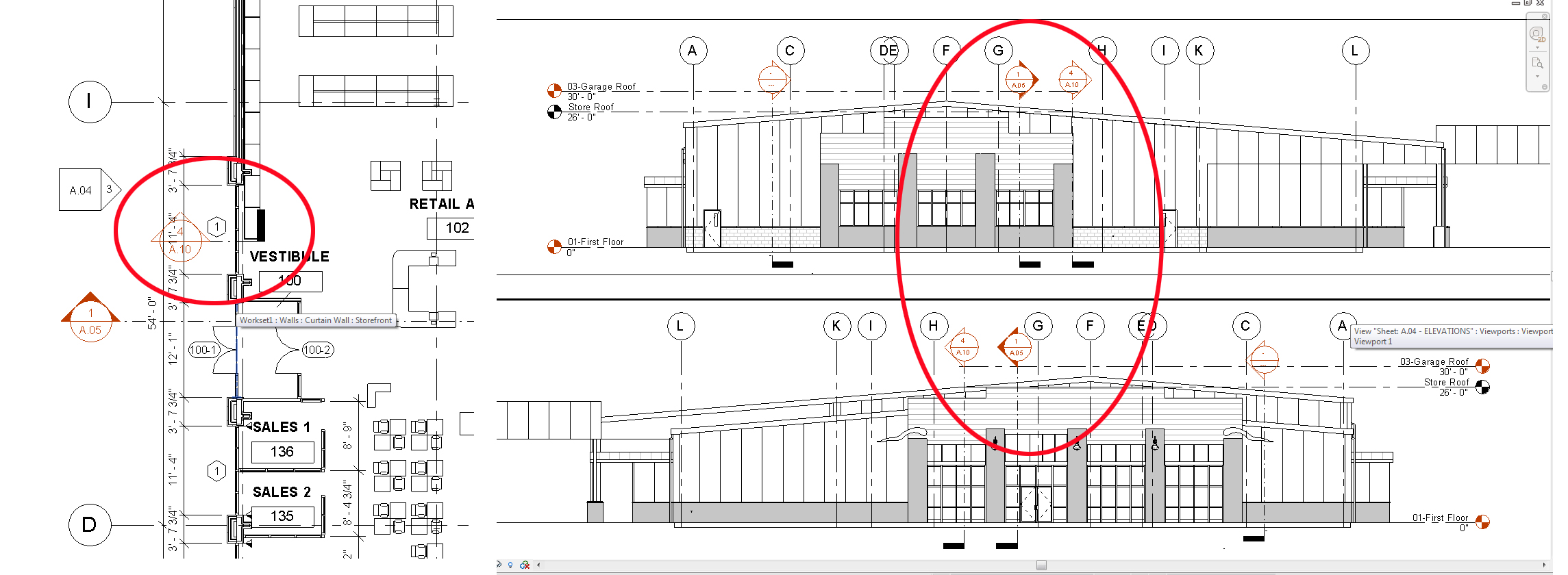

I have a wall section that is showing up on both the north and south elevation of my building eventhough I've drawn in only cutting through the north facade.  (Plan attached)
What setting am I missing.
I only want the section to appear on the elevation I'm cutting it through.
Thanks!
Wed, May 8, 2013 at 2:58:12 PM | Wall Sections Showing up on Both sides of building
Why do you set your elevations to show the full depth of the building?  That just means Revit has to deal with everything in the view including your wall sections on the other side.  Goto your plan view and drag your elevation depth back to where it only includes items that elevate on that side.

I believe in elevation sections will show up eitherway.  You will just need to hide it.
Wed, May 8, 2013 at 3:18:29 PM | Wall Sections Showing up on Both sides of building
No teafoe - If the view range doesn't intersect the section, it will not show.  We always set our elevations to clip / without line.

Ah yes you are correct

That was my problem. I didn't realize I had my elevations set up without  a clip distance.
