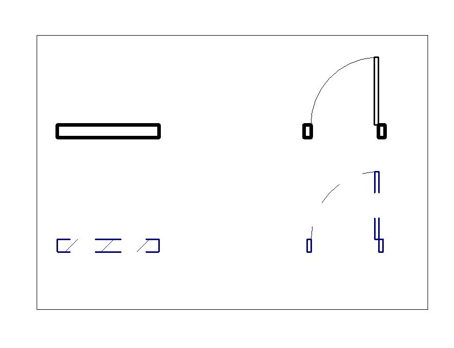

Hi! I am using Revit Architecture 2013. I would like to make a "demo legend" to show existing wall lines vs demolished wall lines (dashed) vs existing doors, vs demolished doors, etc.
I created the legend sheet but I cant drag and drop or copy and paste any of my "symbols" into the legend sheet.

Your right. For some dumb reason, we can't use symbols in a legend.
Place them in a model view and use freeze view to change to detail lines which you can then copy/paste into your legend.

HOW DO YOU USE "FREEZE VIEW" TO CHANGE TO MODEL LINES? I ATTACHED A SCREEN IMAGE OF WHAT I HAVE (STANDARD WALL, DEMO WALL, STANDARD DOOR IN PLAN, DEMO DOOR IN PLAN.

Under extensions - tools / freeze drawings.

THANKS AGAIN, I APPRECIATE YOUR HELP. NO LUCK WITH THIS- I DONT SEEM TO HAVE THE SAME OPTIONS AS YOU WITH MY REVIT SOFTWARE (OR I CANT FIND EXTENSIONS - TOOLS - FREEZE).

OK ... This extensiuon just exports the item to CAD then re-imports it into a drafting view. You can do the same thing manually.
