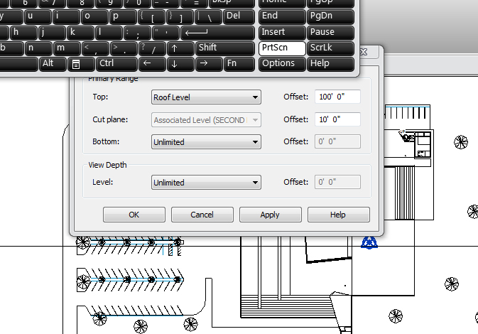

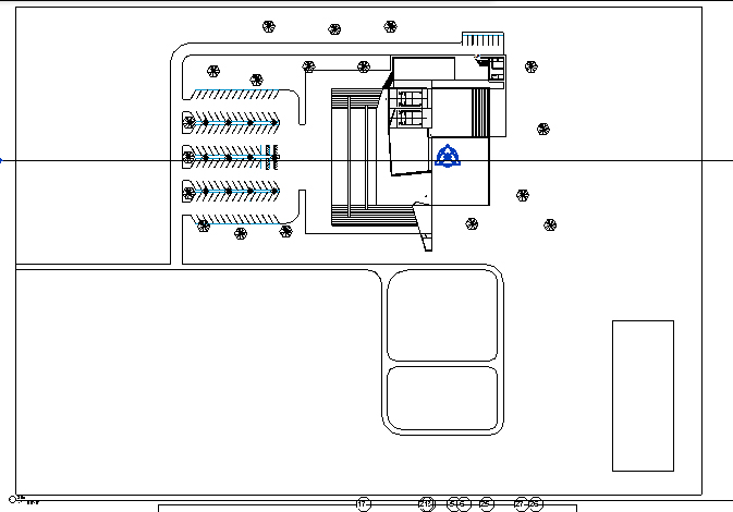

I am having trouble when I go to site plan view, the roof plan is now showing, and interior walls are showing instead.  I know this is the view range, but every number and level combination I try, it still will not show.  My building is 30' feet tall.

Thanks for your input.  I did and still nothing.  See my view range attached.

Your CUT PLANE is set to 10'-0"  not 100'-0" like WWHUB said to do

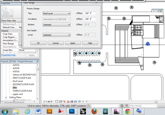

I did that and still nothing.  I took the picture before I changed it.

Thanks everybody.  I just figured it out.  I had to model my roof with ceilings and the ceilings are not turned on in visibility and graphics for site plans.
