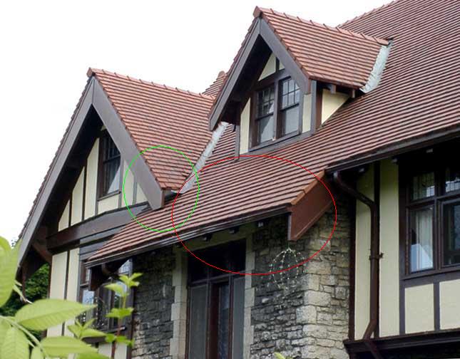

Hi Guys, been searching the internet for days on this one. I know how to create gable roofs, but I want to create a overhang on the ground floor porch enterance. Im using roof by footprint. and revit 2013. I have attached a pictuere of what I want to create. I want the circle in red, while also keeping the green, but can't do this in revit as they overlap if drawn by footprint. Any help greatly appreciated.
Wed, May 1, 2013 at 8:59:51 AM | How to create complex gable roof
The main roof with the overhang can all be one roof sketch.  Your two gables will ahve to be seperate roofs.
Wed, May 1, 2013 at 9:02:57 AM | How to create complex gable roof
niteshrupalia
Joined: Wed, Mar 25, 2009
18 Posts
5 Stars: 1 Votes
I thought as much thank you!
Wed, May 1, 2013 at 9:07:51 AM | How to create complex gable roof
You could also do the main roof and left gable as one sketch with the overhang and center gable as other roofs. .....

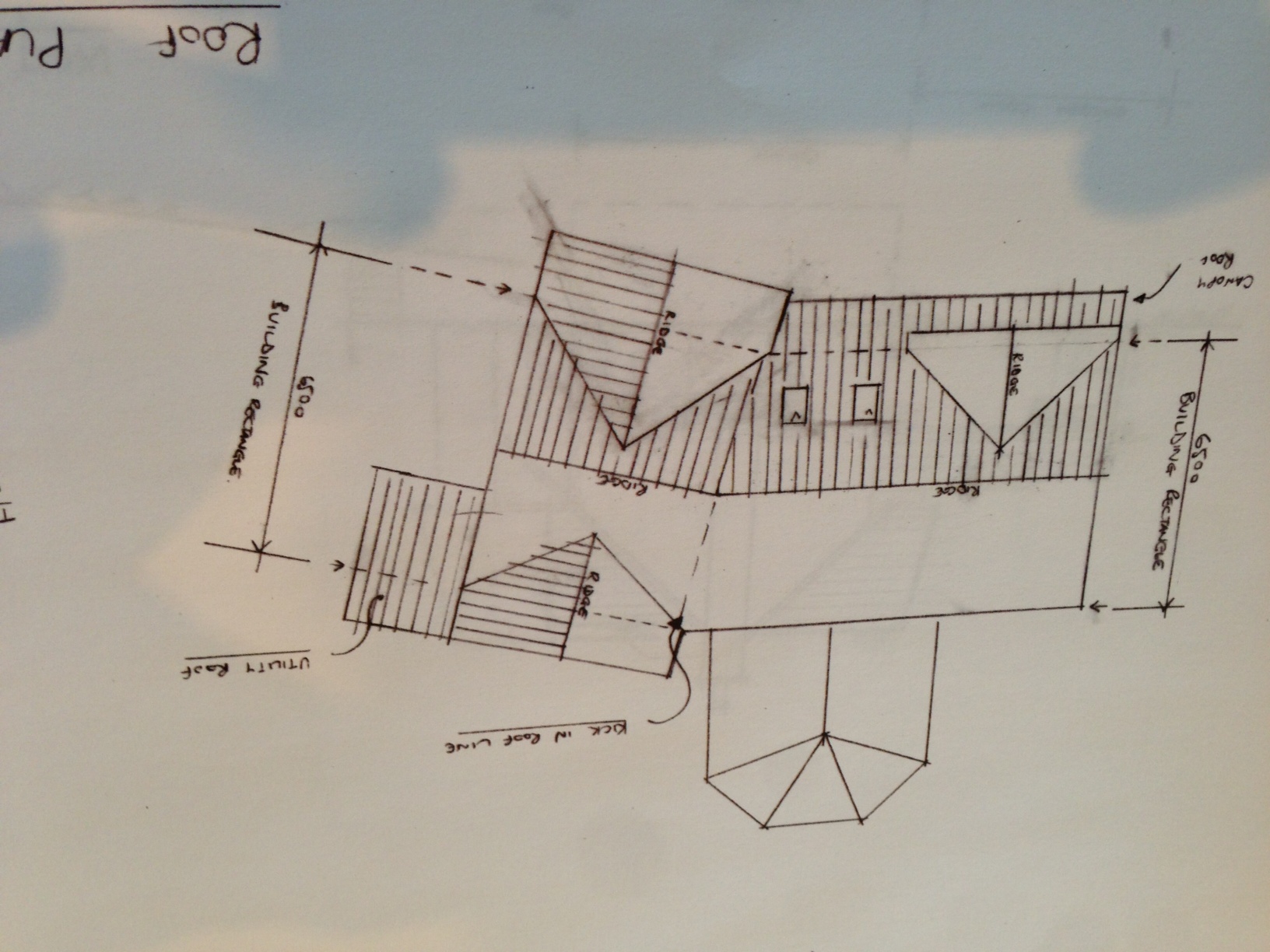

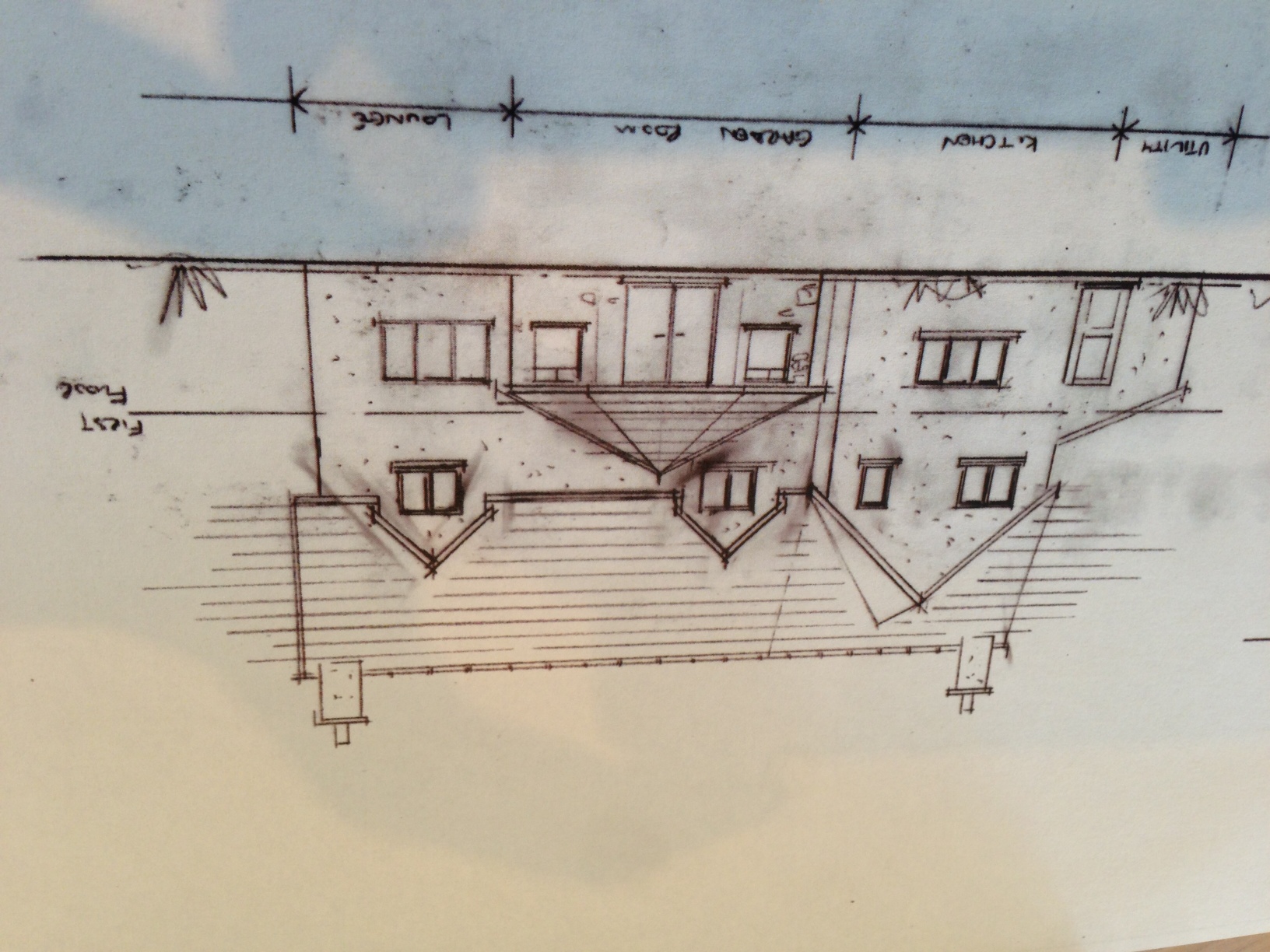

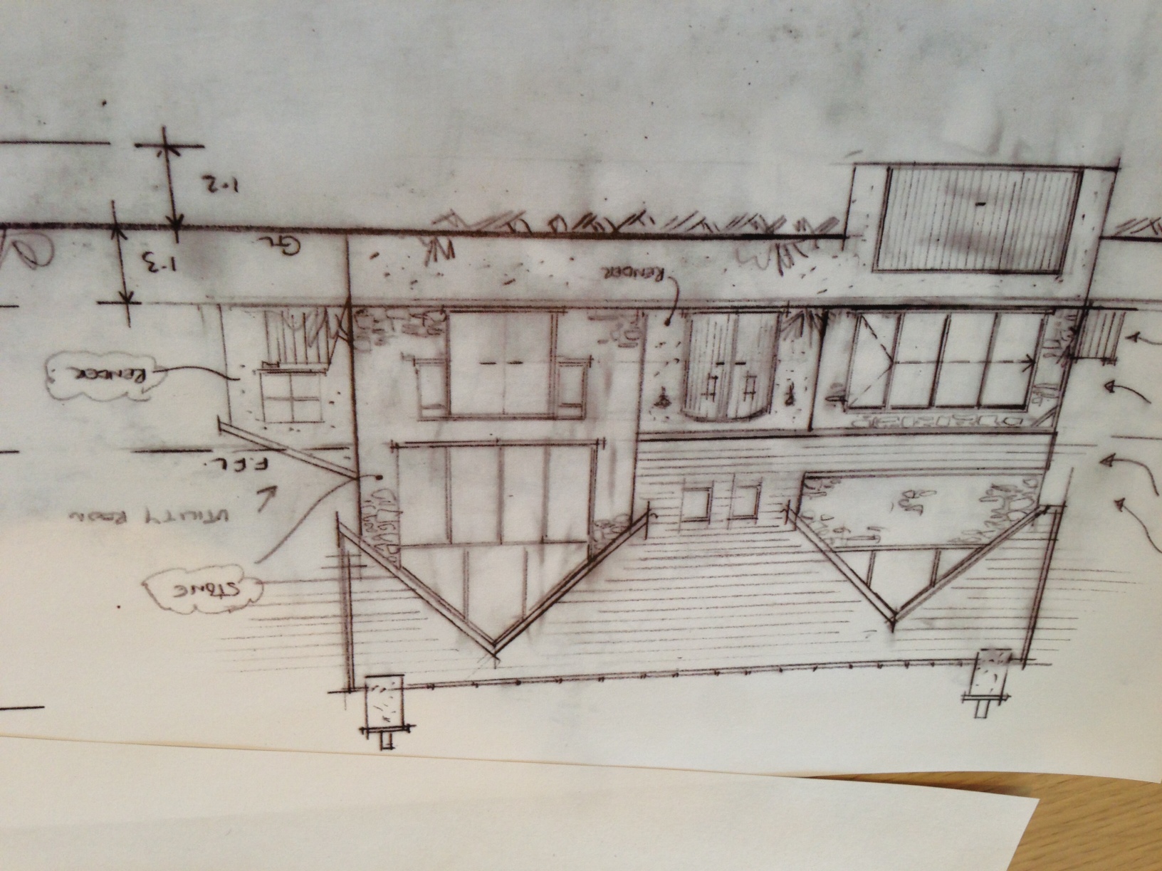

Guys, Im realy having a tough time with this roof, I have attached a roof plan, just can't get the ridge line from the two roofs at an angle as shown.
Sat, May 4, 2013 at 9:15:48 AM | How to create complex gable roof
niteshrupalia
18 Posts
5 Stars: 1 Votes
How would I go about creating this roof, I have tried seperate roofs, but then I have a problem joining them at the kink angle.
Should I create the roof as one and add the dormers as seperate roofs and cut in?
