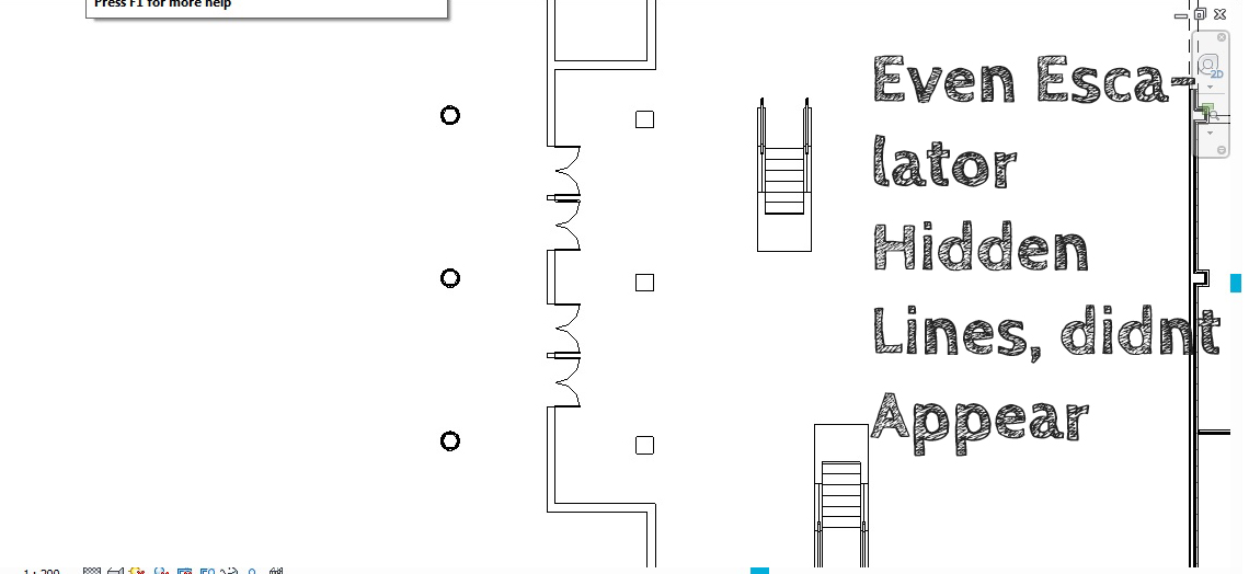

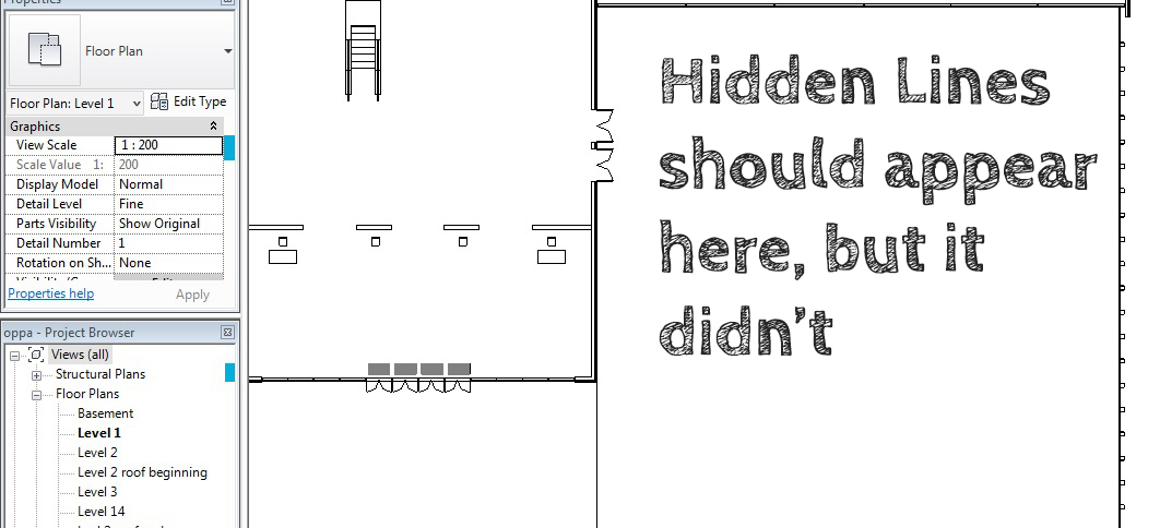

This term design project I decided to work on revit ( Newbie ). really fantastic programm but I face some proplems.
If i cut into a slab I should see a hidden line tells me that the slab in the upper floor are cut.even when i put an escalator. but the revit dont draw
any-hidden line for me. pls help guys.

Thanks alot for you respond,  I couldn't do that in the plan view, Lets say that i have a slab in level 2 (8 meter above level 1) and i want it to appear as hidden line in level 1 ( level 0), note that my view range ( top=2.3 cut plane=1.2 bottom=0 ), even the escalator that rise from level 1 to level 2 ( 8 meter ) in the level 1 only a part of it appear as a solid line (as in image) because cut plane =1.2 meters, but the rest of the escalator don't appear as hidden line, it just dont show. srry for bad english.

You are asking the wrong question.  This line is not hidden, it is OVERHEAD.  Again, from your HELP:
Changing Line Styles for a View Underlay
When you use a level as an underlay in the current view and use the Linework tool on the edges of elements from that level, the elements become part of the current view, and you can modify them. See View Properties.
For example, in a Level 1 floor plan view, you can specify Level 2 as an underlay. If Level 2 has a roof, you can select the roof in the plan view and then modify it. You can even underlay the same level as the view to select a ceiling or beams or other elements that are not shown in the view. You can use the Overhead line style for tracing underlays or define your own line style. (See Line Styles and Halftone/Underlay.)
