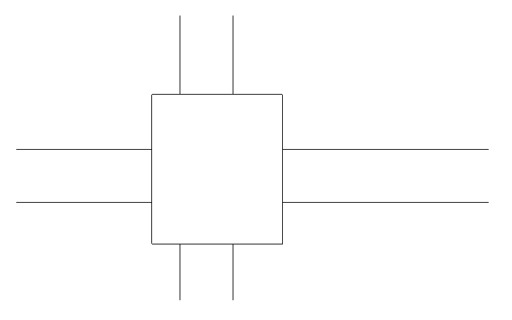

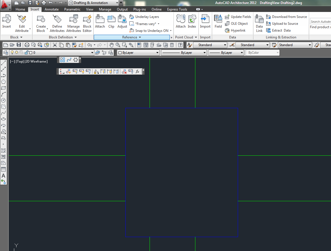

2013 My Revit and my CAD export.  Masking region was not exported but actuall cropped the elements.

Yes it works fine when you are cropping linework.  But in this case I am cropping an imported image.  The image is cropped with the masking region in REVIT but is not cropped when exported to Autocad
