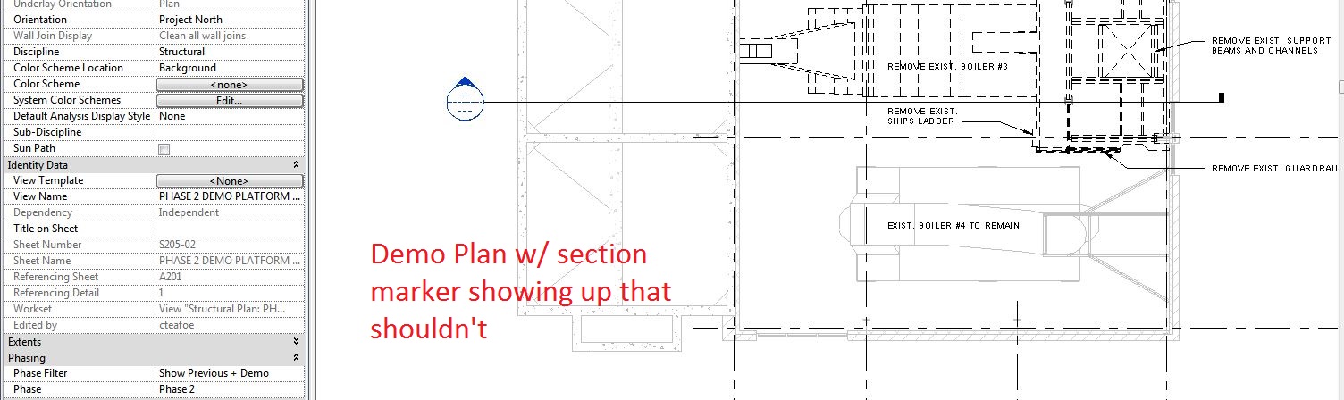

I currently have a project where I am working on Phase 2 (we have 4 phases in one job).  I have a New Plan and a Demolition Plan, (also an existing plan for reference)
When I cut a section on my New plan I do not want it to show up on my Demolition Plan but for some reason it is, I thought my phase and phase filters would get rid of it. If I cut one on my New plan it does NOT show on my Existing plan (thats how I want it) They are as follows
DEMO-
Phase- Phase 2
Phase filter- Show Previous + Demo
NEW-
Phase- Phase 2
Phase filter- Show Previous + New
EXIST-
Phase- Existing
Phase Filter- Show All
I'm assuming it has to do with my phase filters but can't figure out exatly what I'm doing wrong. (its been a long day).

DG it looks like you are showing demo an new in the same view. What happens when you have 2 different views, both on Phase 2, one with phase filter "show previous + new" and one with "show previous + demo". Then place a section in the New work view, does it still show up in the demo work view? I need to have a demolition plan and a new work plan separate yet in the same phase.  Hope I'm not confusing you.

I think you are trying to re-define how Phasings works. Items create in the same Phase are the same. I think you are
going wrong by thinking that your deomolition plan and new work plan have to be in the same Phase. When you create
Section marker it take on the Phase properties of the view. Since you have the Phase set the same for both Views, the
marker is displayed in both views.

The reason that it shows up is that when you created the section mark in the view with the filter Show Previous + New set. The Section mark inherits the Phase and Filter setting from that view. Section marks can have both Phase and Filters set, where some objects can have only the Phase set. I can't verfiy that at the monment, i'm not at a Revit computer.

Correct I have the section mark set to Phase 2 with a Phase Filter of Show Previous + New and its still showing in the demo plan (phase filter of Show Previous + Demo) which shouldn't show and New so why would the section marker be showing?  I appreciate the help.

If you were trying to draw new model objects that would be true. If you try and draw new model objects with that filter
set you should get a warning. You should also be able to place new text when that filter set also. Thought the text
annotation will be view specfic, it seems that whem placing Section markers. All views set to the same Phase inherit
the marker as thought it was created in that view. If you create annotation in a view and change the filter it has no effect
on the display of the text (i.e. annotation objects) which also includes Section Markers. That's the only reason I can see.
