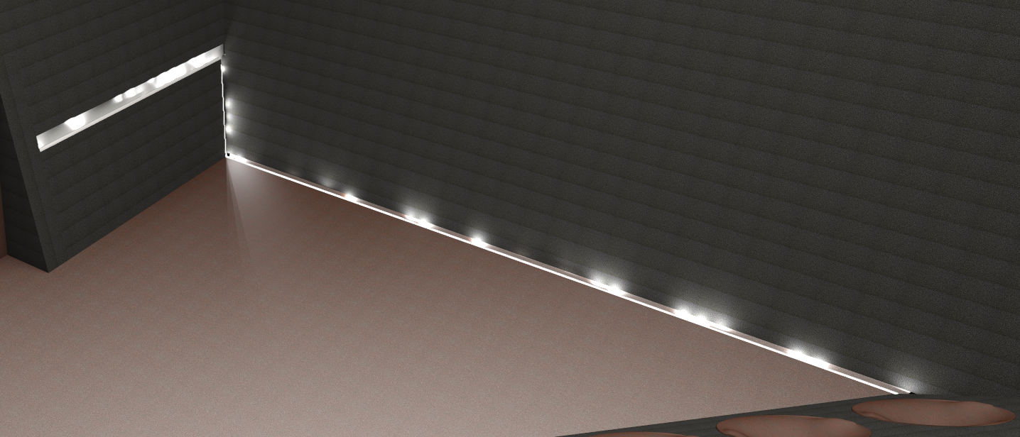

Hi everyone.
I created a solid lamp, put it in a void and I'd like to have a single light coming from that void. But my light have separate additional flashes. Is it possible to remove them? (see the image) Void is single, doesn't have any breaks to reflect additional light. I used component in place, void by sweep and then cut all floor by one sweep.Lamp is created as a simple sweep with material that has applied self illumination properties.
Any suggestions? Thanks

oh, image didn't upload. there is it.

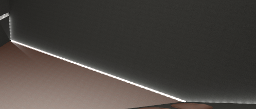

Finaly solved it! The lamp sweep was round profile, now I made profile in shape of triangle with flat top side. It worked!
Sorry for spam, took me a lot to solve it ;]
