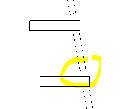

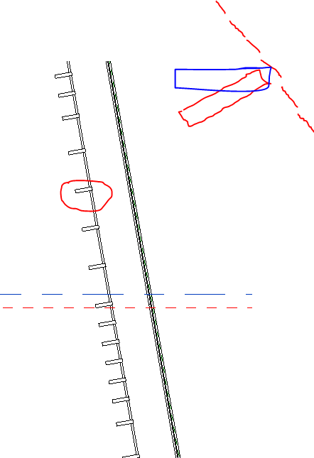

Hello, is there a way to say to the Curtain wall which is applied on a sloping mass to generate horizontal mullions? Please see the section: I would like the mullions to generate e horizontal section.

You may be able to create a mullion profile to do this.  Experiment and let us know.

I duplicated the family type for the mullion and I change the angle
but then the verticals do not follow it...
Wed, Apr 24, 2013 at 10:01:29 AM | Curtail wall on Sloping mass - mullions to be horizontal
Can you edit the joins on CW by face?   If so, then make the verticals continuous - which is what true Curtain Walls would be built like.
BTW - In a built environment, would you really ask for special extrusions to do this?  Recognize that the glass edge and mounting is still square with the slope.
