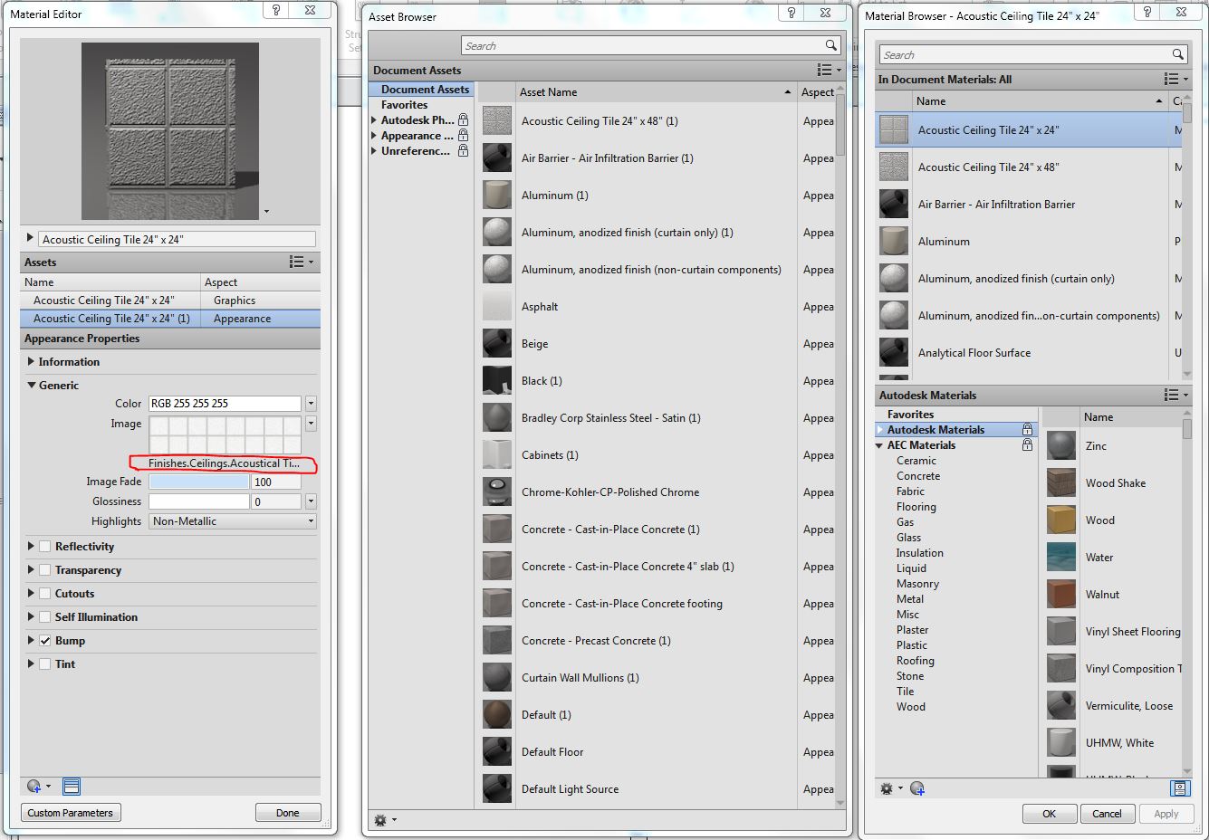

In the material editor click the name below the image and it will open a window where you can browse for your new image.
