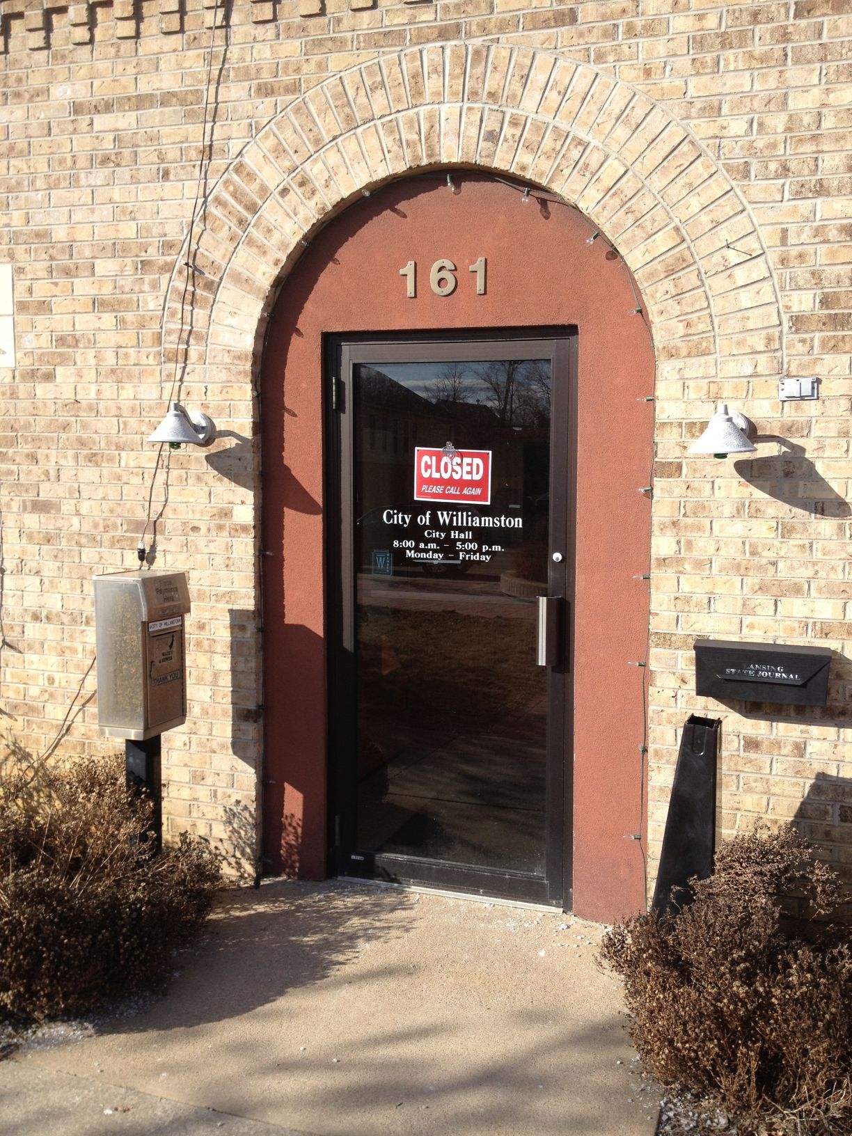

Hello!  I'm new to utilizing wall sweeps.  And model-in-place components.  I'm wondering what the best approach might be the build this door and arch (see attached photo)?  Thanks in advance.

Ohhh...it was a 3MB file...See attached.  Thank you!
Thu, Apr 18, 2013 at 2:59:45 PM | Wall sweeps around door?
For the arch, you could make a special family based on the same principles used in an arch top window here in the downloads.  But I would probably do a model in-place element slightly proud of the brick face as an arrayed element.
The inside area is a seperate wall with door.  Sketch edut the wall to cut the hole in the brick wall.
