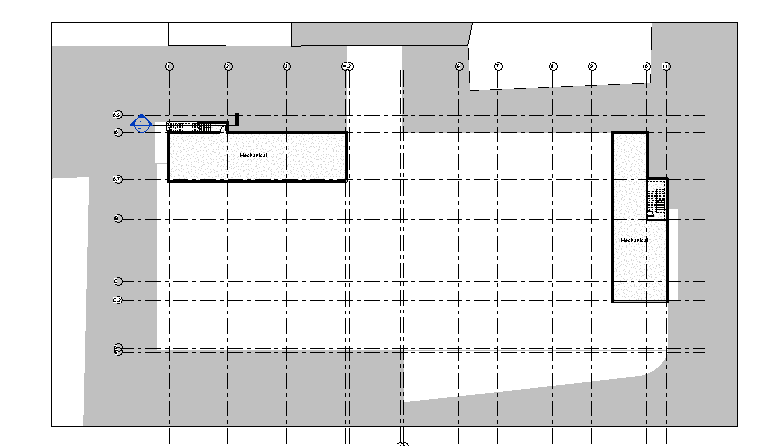

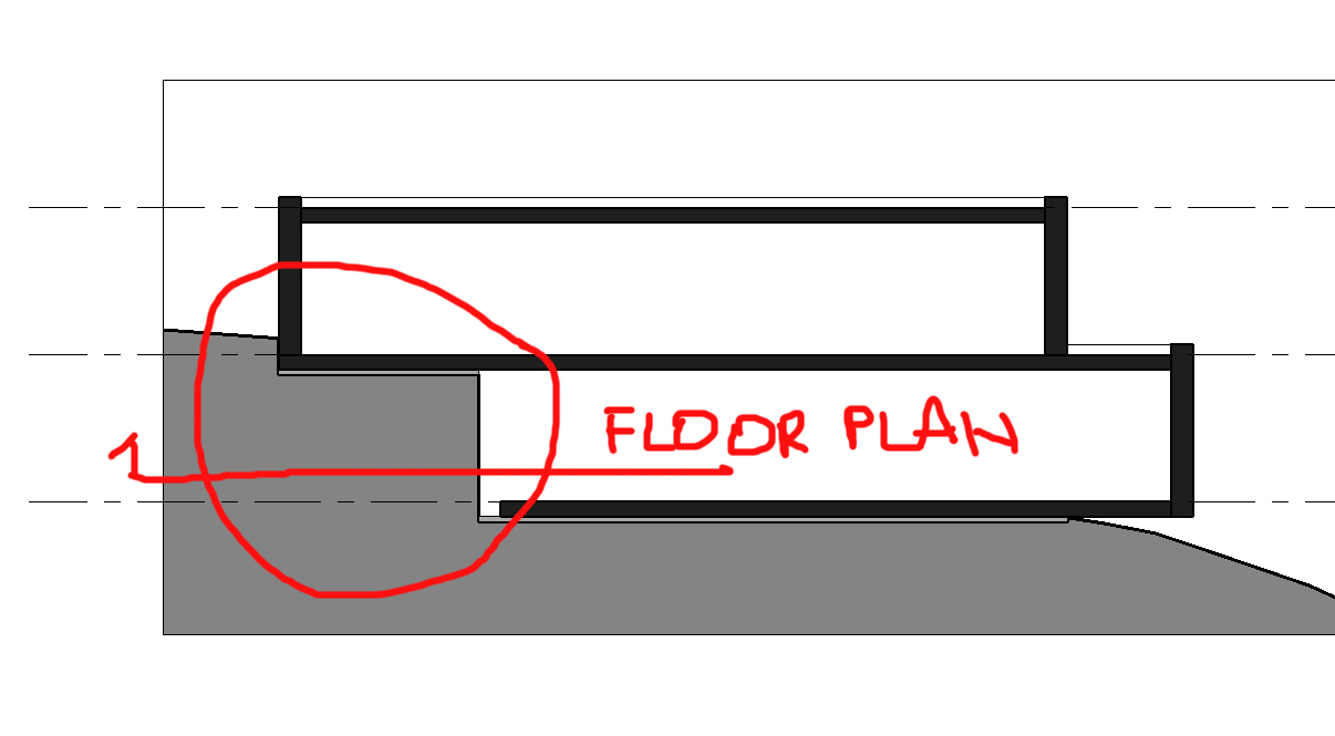

I've been trying to search for an answer to this but cannot seem to find anything.  Maybe you guys can help.I have a main level in my building, with a basement that has a smaller footprint than the floor above.  I have a pad defined for the area that is on grade at Level 1, and another pad defined for the Basement.  In my basement plan, wherever the pad is above, the topo fill/hatch does not show.  See the image below for clarification.Is there any solution to this?  I know I'm not the only one who has had this problem, but none of the threads I've found have a resolution to this issue.

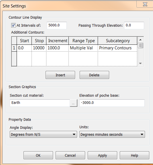

Either way you should be aware of the Section Graphics and Elevation of Poche Base as shown in the attached image.

Yes, I am aware of the section graphics (after some digging (no pun intended)).  I am using the pad as my gravel base.  However, it is on the layer above, to cut out my toposurface for my floor.  But on the level below, underneath the pad location, no fill/hatch for the toposurface shows up.  The white area on the image I posted should be poched gray (or hatched - in this case I want a solid poche and not the typical earth hatch), but wherever there is a pad above, no fill/hatch appears.

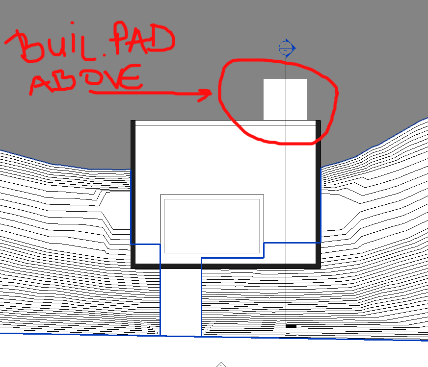

Look at pic.
Yes it shows fill paterns in the plan, but when building pad is above, the hatch disappear!

That's the point. It has to be cut.

Is there solution not to be cut, because I need to be cut only upper level and not ground below building pad.
When we put building pad, no matter on which level, it's acting like it extends vertically infinitely?
