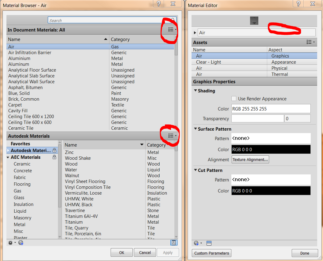

Any know how to make the wait time for opening the material browser shorter? I seem to be waiting extremely long amounts of time for the material browser window to pop up to select materials (1.5min-2mins) Just built a new comp that is very fast so its not hardware.

Turn off the Thumbnail views go with 'text viw'. Also squich the preview down in the material editor dialog box. See image.
