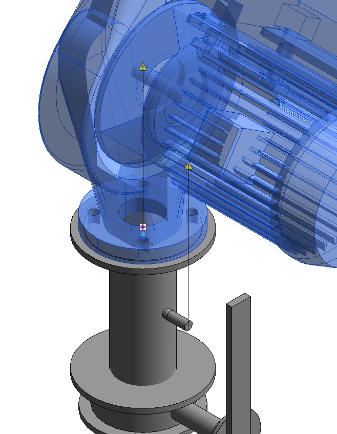

Ive tested my model using the show disconnects tool. Most components have linked successfully. Even when i drag the two items together by the end drag/snap points they still are not connecting. Is there a tool im missing to connect items more accurately?
Image attached of an example between a pump and pipe,

Check the connector types in the families. Connectors can have 'direction' ----> Maybe that's the problem ? As in in bound, out bound.
