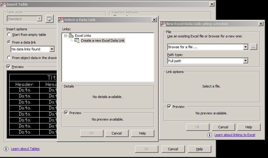

I try to avoid this workflow, though sometimes it's required when your back is against the wall. How did you insert your excel table into AutoCAD ? The way I got it to work was to use the 'Table' command then insert the data from the excel sheet using the 'From a data link' insert option. You can specifiy the range of cells you want to capture in your spreadsheet using this method and then you can insert into your Revit project.
