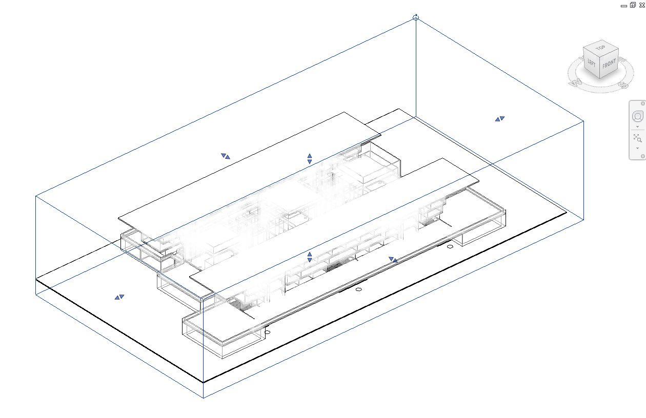

Hello,
Can anyone tell me why the 3D view in my Revit 2013 file displays clouds obscuring the building form?
Thanks
MDW

Hmmm... Graphic card issue, update drivers.

Typhoon,
Thanks - for future reference I went into File, Option, Graphics. For some reason the default which is set here is the box ticked to 'Use Graphics Acceleration' Graphics Mode. On lesser powered machines, as I was viewing the model on, the clouds appear within the 3D view. Untick this box, close and reopen the software and the issue was gone.
Thanks again
MDW
