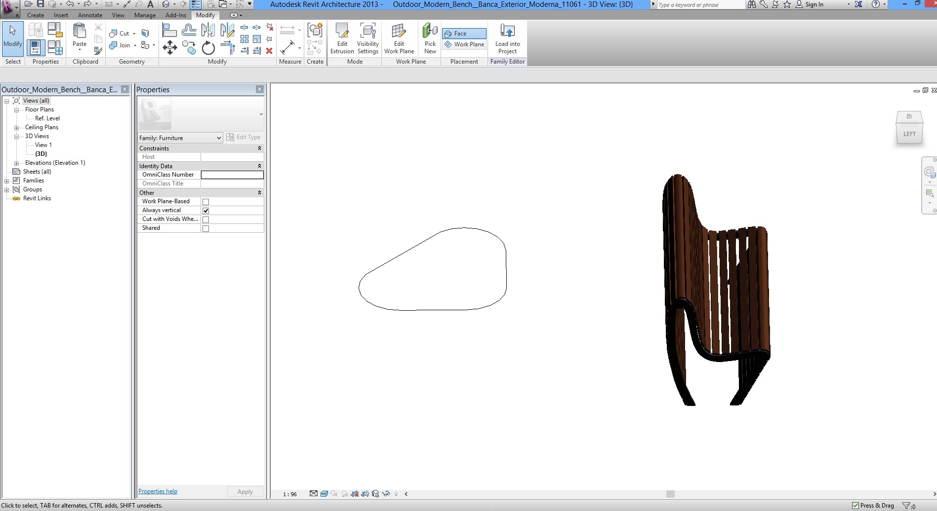

First time I used this forum, and I also very new to Revit. Here goes my question:
I downloaded this bench from Revit City, and now I want the back of the bench to follow the circle (figure) I made. Can I just sweep the bench around it, how do i go on from here?
I'm using Revit Architecture 2013
Thanks =)

Where you should go from here is to learn some fundamentals of Revit.  Take a course, read some books and at least Read your Help.
Read topics on sweeps.

Was the bench made as a sweep? I doubt it was.  All you can do is move and rotate the bench to the position you want it around the area shown.
You could create a profile of the bench and sweep an in-place model around that selected path. However that will give you a solid bench.
