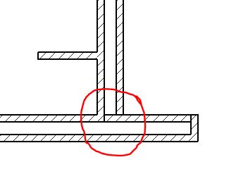

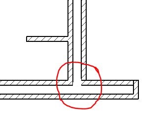

Hello, i got this problem with a stand alone wall i can't figure out.
How do i remove the wall inside the wall in the picture?
Mon, Apr 8, 2013 at 8:36:30 AM | Wall crossing problem
We can't help because you don't really tell us anything.
  1. Look at materials. < Must be same material to join
  2. Look at wall layer priorities.  < A 1 will not join with a 2 no matter what material.

Can you tell me exactly what you mean by materials? All of these walls have been tried with same materials on both sides, if thats what you mean?
I attached a new photo to show you what i mean. I want to remove the piece of wall, thats inside the other wall.
Mon, Apr 8, 2013 at 12:29:38 PM | Wall crossing problem
What did you do? .... add a masking region?  Don't do that.
Model it like you build it.  If the crossing wall is one wall, just split into two walls and "trim extend to corner" each half and the 'T' walls..

use the wall joins command under modify or pull the wall apart and rejoin them in the order you want.

the problem here are wall layers.
Finish1 vs finish2 vs substrate vs structure.
If walls meet which have matching layers, they will join MUCH more nicely.  Otherwise, structure will extend to meet structure, etc.
