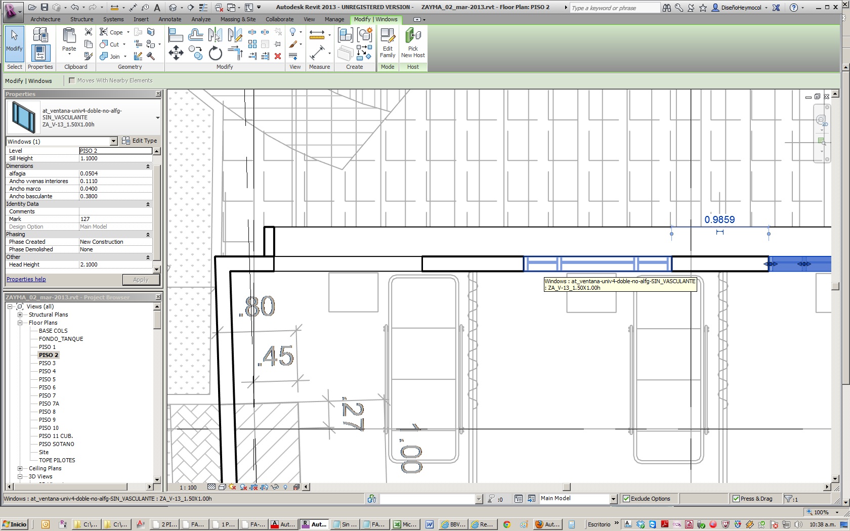

Hello my loved community, can anyone help me? I made a window family that seems to work ok, but when viewing in plan it doesn't appear. The visibility settings are all checked, it can be seen in 3d view and elevations and in sections. And (weird) when I hover the cursor over it (in plan) it shows up. And the cut plane is at the rigth heigth. What can I be doing wrong?

Do you have more than one wall in that area?  Review warnings will show you duplicates in the same place.  Also....just delete the wall and see what's left.

well, there is no double wall at all. And if I insert an original revit  window, it looks ok. And if I delete the wall, the window also is gone. And.. in wireframe it does show up. I think it could be a problem with the "openning cut" but it is there.
