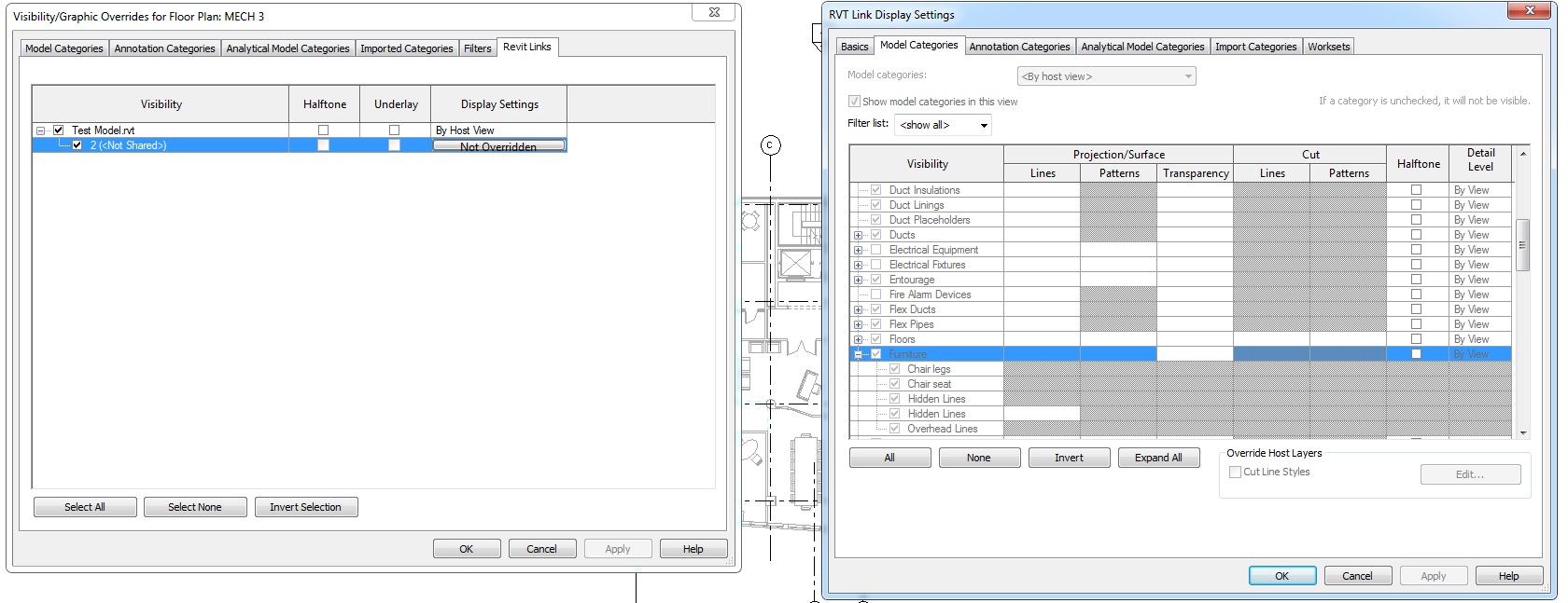

If I open a new arch model and detach from central I have full comntrol/access over model as far as display settings, hiding layers and such. If I create an MEP new project and link in the model I lose that control. I cannot for instance "Hide" the "Furniture" on a floor plan. The options are greyed out.
Is this normal or am I doing something wrong? How do I control the visisbility of a lionked file?

Linked model VG is controlled per view in VG......You will see a seperate tab for linked files, then new VG settings for each file.

I am in the Revit Linked Tab and all of the options are greyed out.
See attached screen shot.
Mon, Apr 1, 2013 at 10:44:02 AM | Linked Models
On the main line of that "Test model" - click on the "By host model" - change it to custom - then in the model tab - change that to custom and do what you want.
