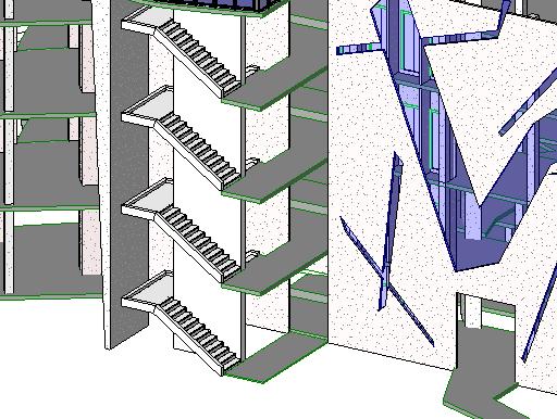

Hi! I need to make some uneven shaped windows in a house. I have 3 pictures with ideas of how they should look like. It's not neccesarly to be a window as a component. I am qutie new to Revit and I'm still discovering thngs. I made a hole in the wall with the edit profile but then I cannot put a simple glazing panel in there. Picture number 1 reprezents more what I want to make.
Could somebody help me?
