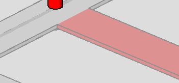

I've worked on a number of BIM/Revit projects where Workset Management has been very important for one reason or another. I wondered what peoples thoughts were on a good & efficient Workset Management system that ensures everything all elements are kept on the correct workset before the model is issued.
My current system:
I set 3D working views up that have filters applied. Say I want all elements on L1 to be on the L1 workset (as an example). I'd have a filter that says 'if not equal to' 'L1' make it's surface and cut patterns red. Then in my 3D I visibly see if a another user has missed something. Obviously you can grab and filter all elements and bulk change them to the correct workset..sometimes..though I this appears to be a more full proof way.
Does anyone else have any other suggestions ?
