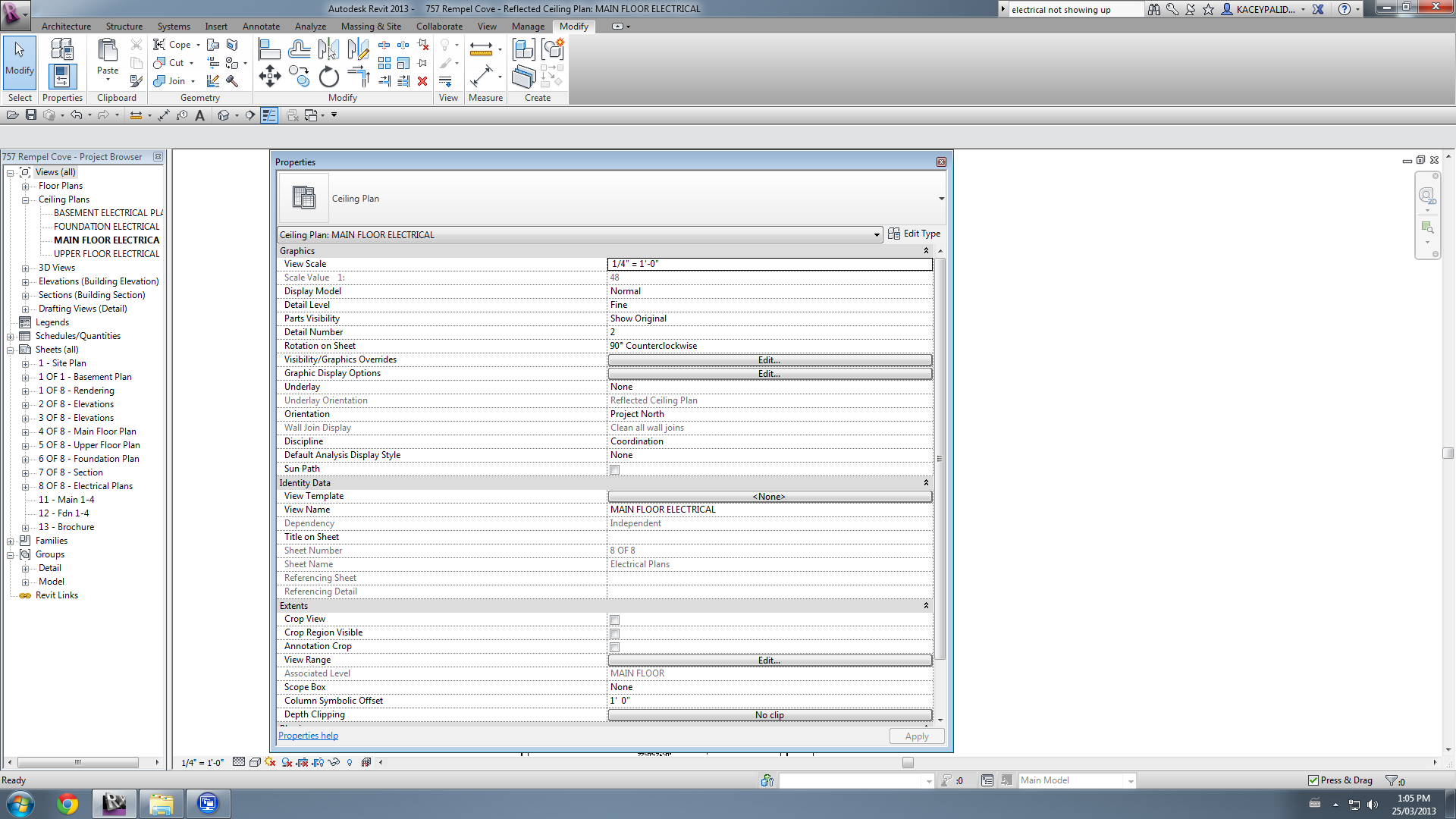

I am using Revit 2013, and am having issues with getting my electrical to print. It shows up on the computer screen, but is not visible in the print preview, or when I print. I have gotten it to work in other files, and it prints fine on my foundation and second floor of this particular file. It only does not print for my main floor. What the heck is going on?! Any help would be much appreciated!

Sorry, it was vague. Nothing is temporarily hidden. I used a ceiling plan to create the electrical plan, but there is nothing that I can see that would be blocking my components from showing up. I have no overrides on the electrical components either.

If the items are not within the view range, then they will not print.  I assume they are because you say they are on the screen.
You need to show us some screen capture images.  Of the plan - of the view properties .

I hope these help.

I have figured out the problem. I was printing with vector processing checked off, and as soon as I switched it to raster processing it printed with everything showing.

There is definitely a bug relating to this.  I was having the same problem and eventually isolated it to one masking region that was somehow causing this.  Sounds crazy, but deleting that one masking region made it print correctly.
