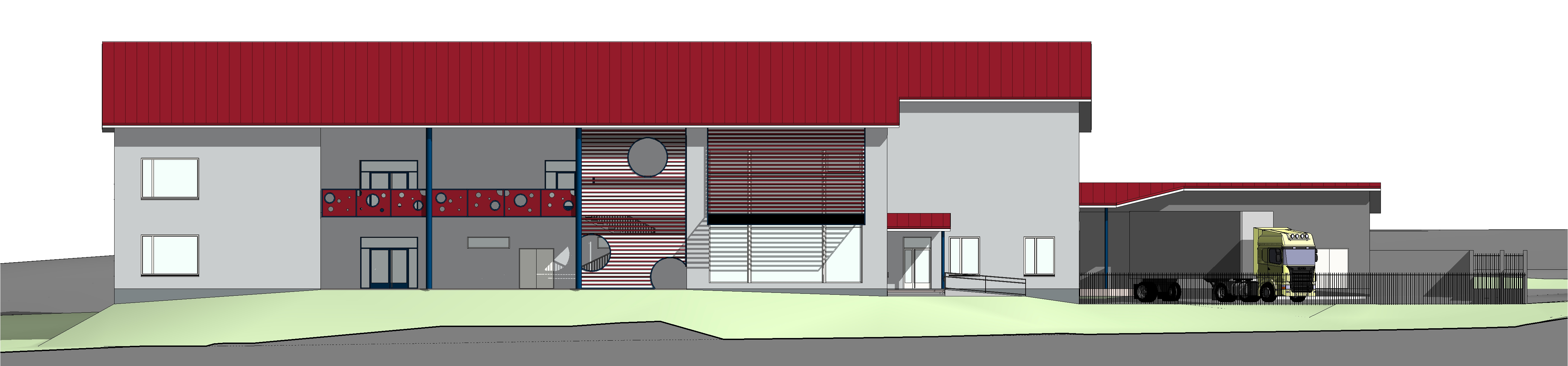

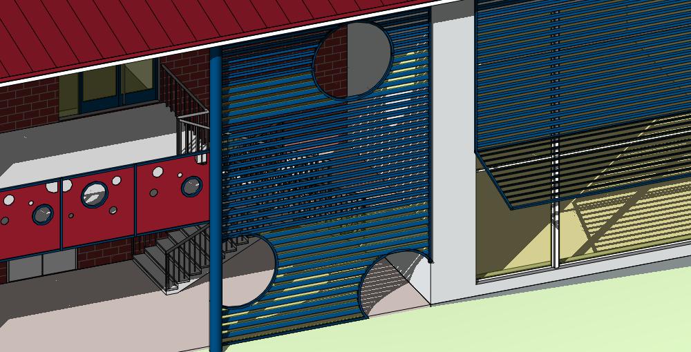

I have little problem with curtain wall empty panel. Panel and mullions looks empty untill i make opening on curtain wall. Panels tunrs in to glass. Can anyone help me for this and tell what iim doing wrong

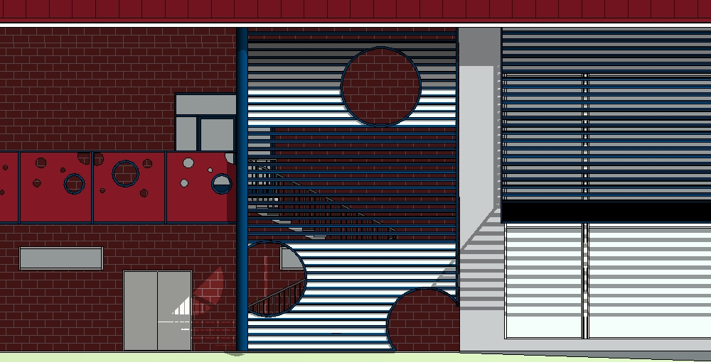

The problem is that trellis i want get that panels should be full transparent (no glass), but on elevation view it puts glass between grids because of those round openings. If i try change those individual panels from glass to empty panel Revit  gives an error note "Missing curtain panels will be replaced with system panels to complete command" and after that Revit tells that some panels are slightly malformed... and some of panels are very narrow. If i erase grid system Revit will change whole cw to glass except those round openings. Openings are made by "edit profile" command but if i use opening command it also replasce empty panel with glass.
I think that problem is those round openings because before addinng those holes cw worked just fine even with my self made profile mullions.

I don't see glass - I see holes!

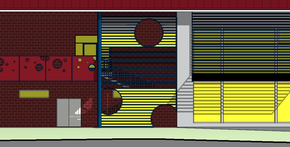

I turn glass sheets into yellow. Can you see problem now?
Mon, Mar 25, 2013 at 1:25:49 PM | Curtain wall - empty panel issue
Now you are communicating better.  I was looking at the holes because that is only waht you were talking about.
Isolate this wall.  Now cross it vertically or window it and filter for the CW panels.  Set them to empty.

Sorry but it appears that Revit does not like an empty panel against a curved edge be it internal or external.
I would make this a special glass - 100% transparent..... no reflectivity.

Ok. Thanks a lot for trying. Only problem on that solution is that glass fills are not transparent in elevation views...
Mon, Mar 25, 2013 at 2:34:28 PM | Curtain wall - empty panel issue
#14
ElLoponen
Joined: Tue, Apr 27, 2010
8 Posts
Sure i can override single glass panel in elevation transparent and it works... Thanks
