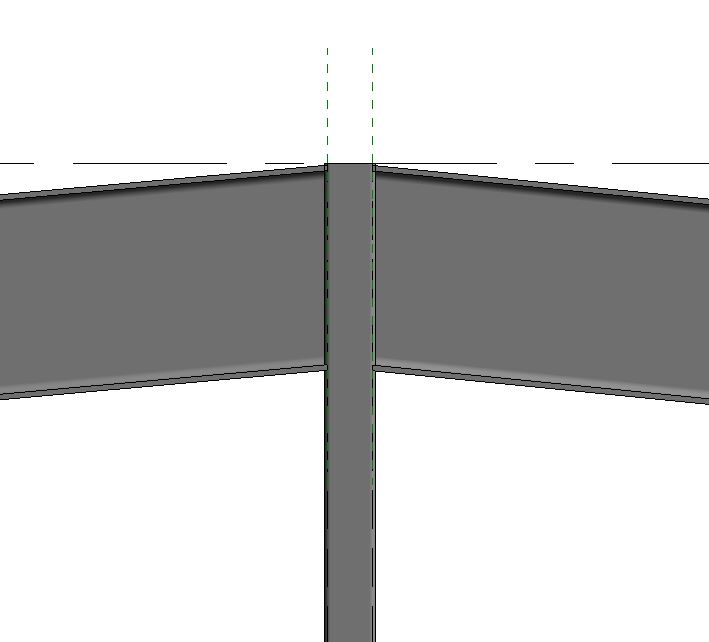

I have modeled my rafters as beams and cannot work out how to get the rafters to cut plumb with the column?
i have attached an image showing my rafter and they are cut 90° square to itself. is there a way off getting the beam to be plumb on the ends so they are parallel with the columns? any help would be much appreciated thanks.

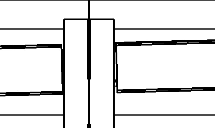

Are they really going to cut it plumb in the field?  I tried to do it using the cut geometry picking the beam then the column and couldnt get that to work for some reason (I did it real fast to try do I may have messed up) however I did get it to cut by placing a reference plane on either side of the column and using the cut geometry by picking the beam then the reference plane.
