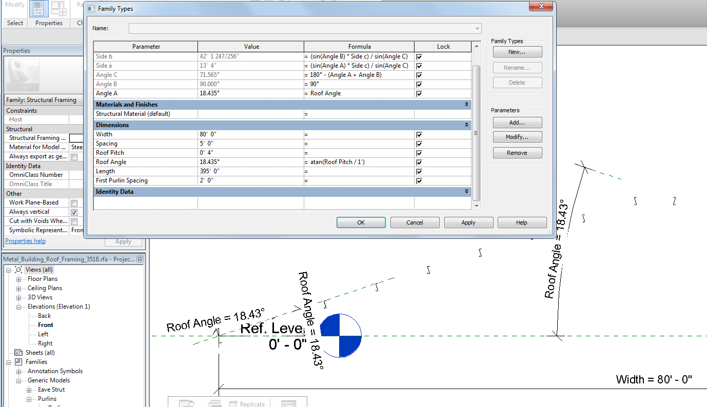

Mon, Mar 18, 2013 at 10:28:39 AM | Detailing Help!
I do not know where I originally got my family.
The individual purlin is nested in a "purlins" family that is nested in my roof framing family.
Attached are the parameters.
A good exercise to learn on.

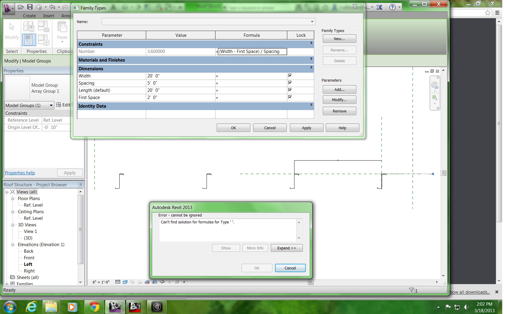

Mon, Mar 18, 2013 at 1:04:28 PM | Detailing Help!
#9
althouse08
Joined: Tue, Dec 4, 2012
24 Posts
Ok this is what I entered and I got this error message. I am not sure if I am doing this right at all.

Mon, Mar 25, 2013 at 9:13:10 AM | Detailing Help!
#10
althouse08
24 Posts
I still cannot seem to tackle this issue. Any idea what I did wrong?
"The road to success is always under construction"
Mon, Mar 25, 2013 at 9:27:52 AM | Detailing Help!
#11
First, although it appears that you don't have others,  - make sure you only have one type in the family initially.  You can add more types later.
This may be a units issue.
Mon, Mar 25, 2013 at 10:06:17 AM | Detailing Help!
#12
althouse08
24 Posts
I think it just started with length..
