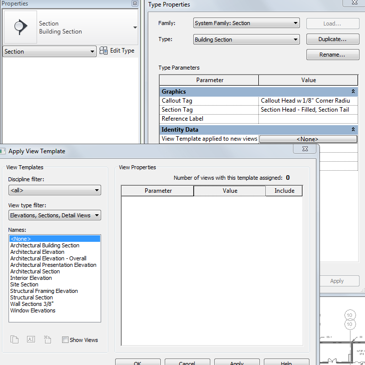

Wed, Mar 13, 2013 at 4:16:24 PM | was given a central model, am unable to view any new section cuts
You can set a view template to use when creating the view initially but it will not be assigned.  See attached.  Edit type then view template applied to new views.
