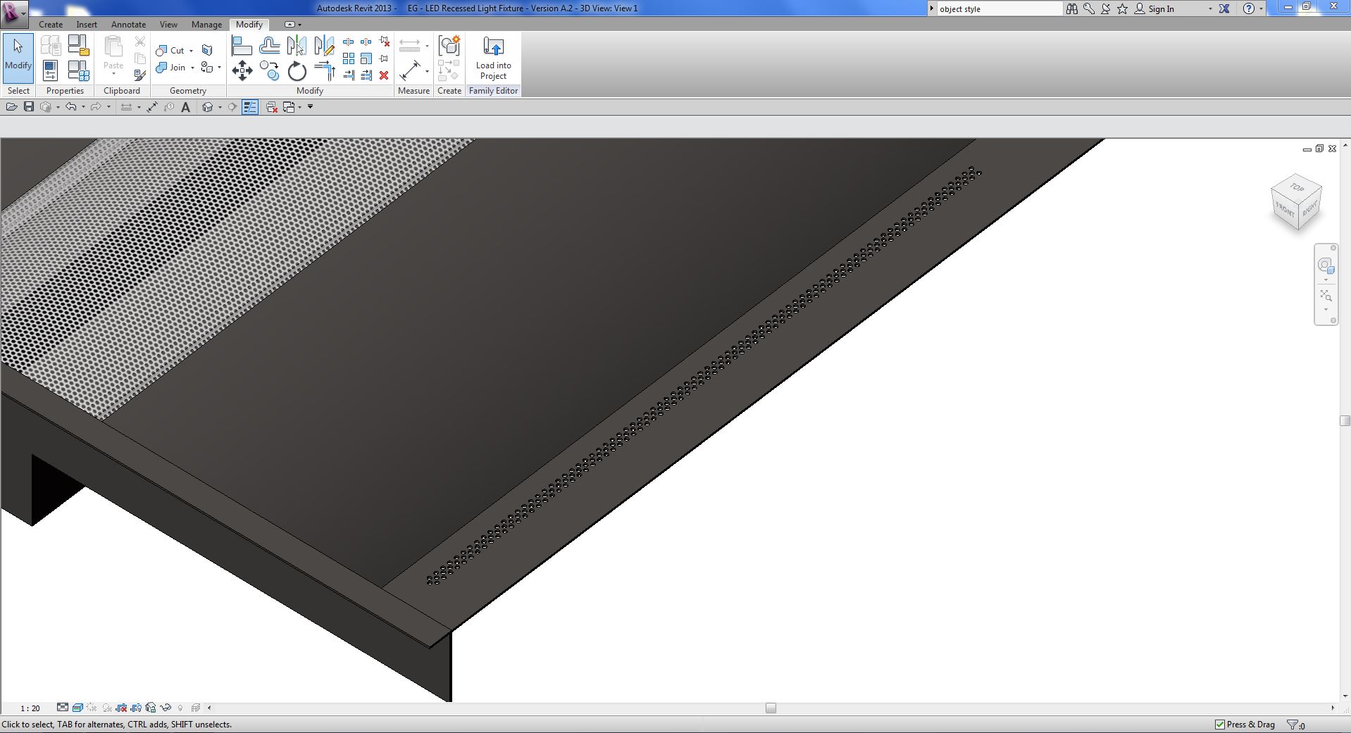

Hey Gang,
I've created a series of perforation (voids) on a new surface. These perforations (5x5) are in a nested family, that I arrayed a few times.
I need to do this in 3 new families, so in the end, my project slows down.
So I was wondering, is this the best way to do this?
Heres a screenshot...
Thanks for the help!
Phet

Sorry but you used a bad process.  You model will be overloaded if there is very much of this.  Fortunately, Revit has a simple material assignment for just such a thing.  Look in your standard material library under metal and you will find an example.  Then look back here and do a search for other posts here because this has been covered before.  I don't remember the key words so look.
Here is the post: http://www.revitcity.com/forums.php?action=viewthread&thread_id=20249

I agree with WWHub. I would use a material assignment.

Can a material be assigned to only a section of an extrusion?
If you look closely in my screenshot, the lightgrey part is an extrusion, where I'ved applied a material to it. But the darkgray extrusion, it is not the hole extrusion that is perforated. There's only 3 rows of perforation. And to complicate things, it's inset in the extrusion. It doesn't start at the edges.
Any other technics?
Thanks guys!
--Phet
Wed, Mar 13, 2013 at 8:08:32 AM | Perforation of material - Best technique
I would just make that part a seperate extrusion nested in a hole in the other extrusion.

Thanks WWHub, I'll try that out!
