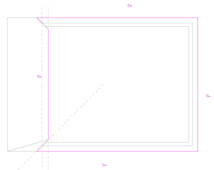

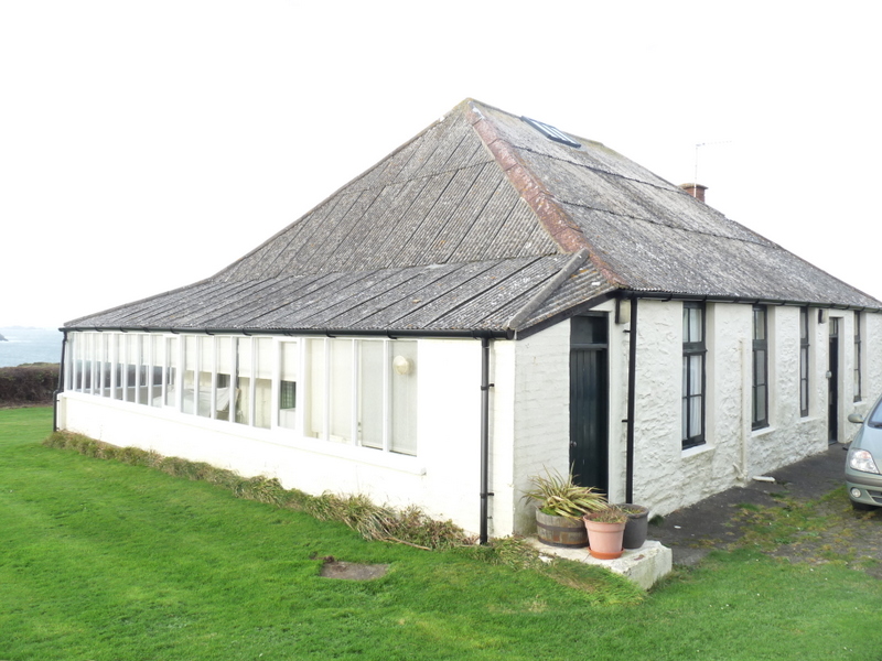

Hi I am drawing and existing building and need help in producing small bit of roof on the corner shown above the door in the attached image? any suggestions?
Any help would be gratefully appreciated
Thanks

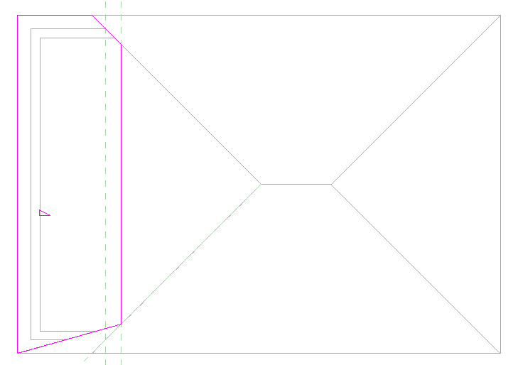

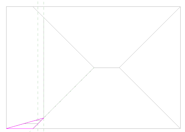

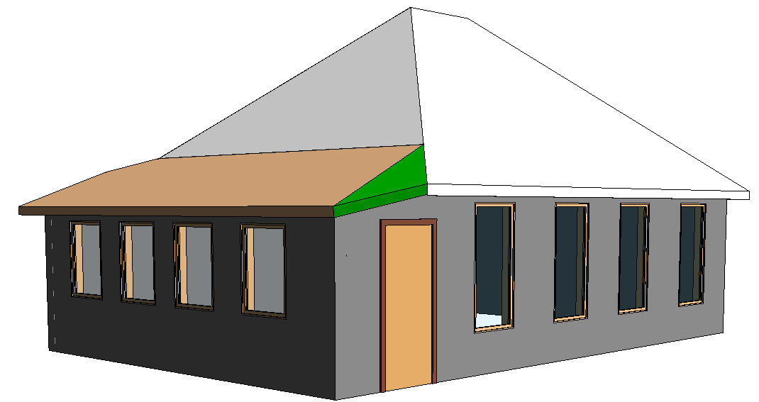

Not a problem.
3 pieces, all by footprint.
See attached images.

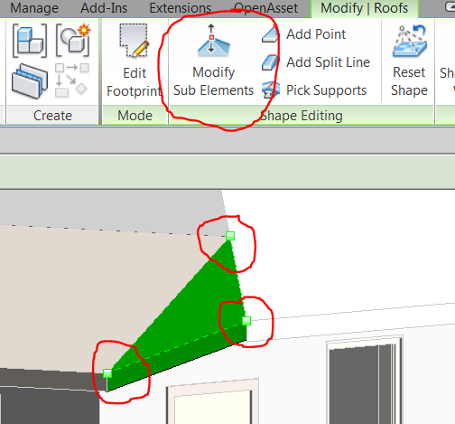

The tricky part is the little pie shaped piece which is originally drawn flat then use Modify Sub Elements and pull the 3 corners into position.
This site won't let me upload more than one picture so I'll comment 4 times.  . . . . actually the images are there but they are very faint.

Ok, the post above has 3 images this post has none and the post below has one image of the Modify Sub Elements.

That is brilliant thank you very much.
