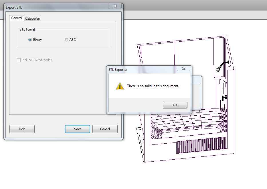

Hello, I'm using Revit 2013.
When trying to export families that I have downloaded as .stl files, I get the error message-
"Family does not contain solid material. Unable to Save."
How do I add materail, or make the program reconize that those downloads are made of something? I have had no trouble exporting stock Revit Library objects, but would like to also print and use the downloads in my model

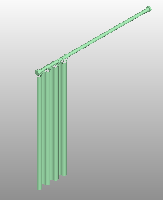

Okay, this tub is a good example. It will export, but when the file is viewed, only the rod and curtain were actually exported. You can delete the rod and curtain and try again, but then the "this document has no solid" error message appears. Something is different on the curtain/rod than the rest of the tub?

The tub is a CAD import.  It is only solid planes - not solids.
