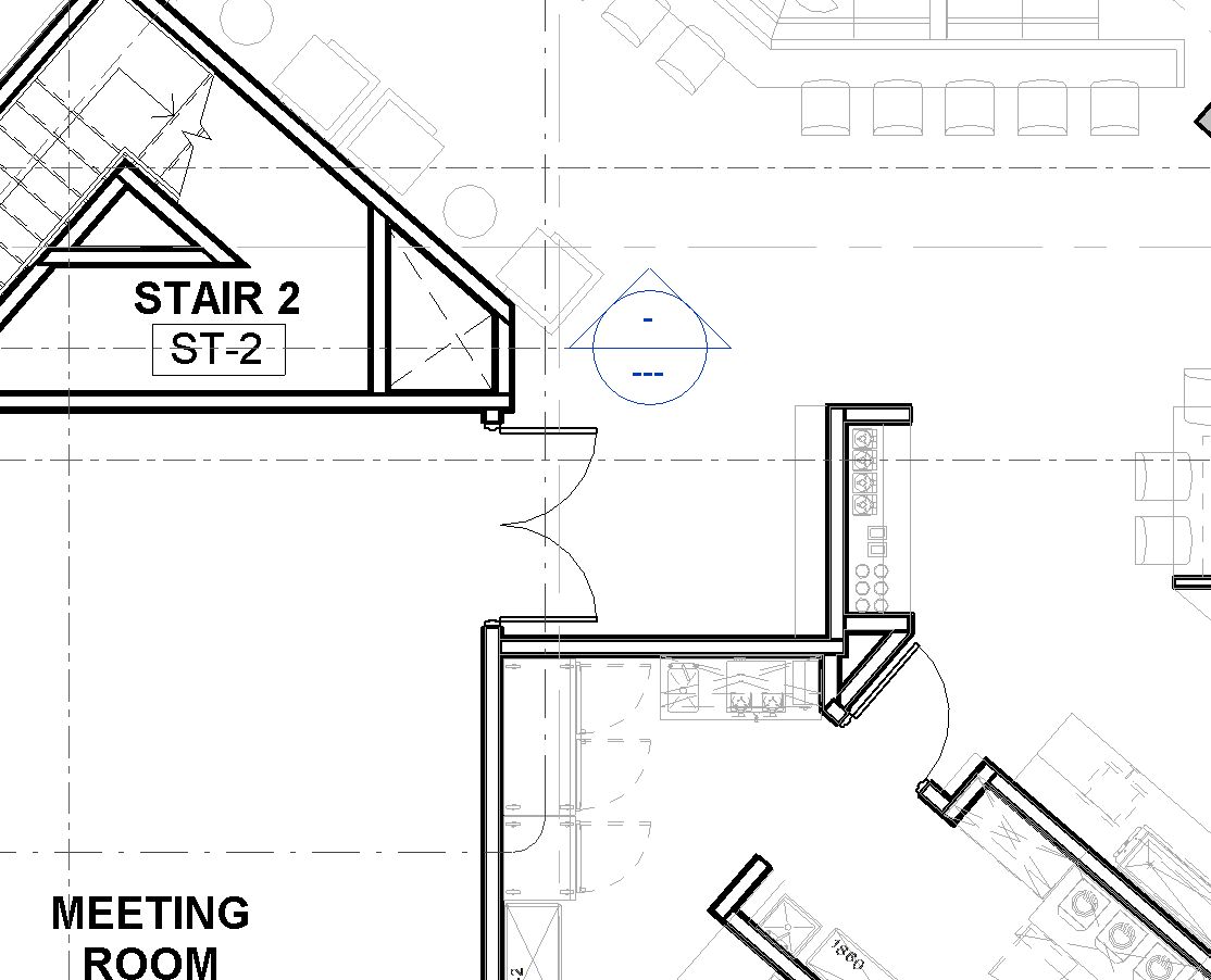

Is there any way to get rid of the extra line in the core layer when two walls join?  See attached image at every joint.

We figured it out, we use Overide host layers in the model categories, and the option for core layer clean-up.
