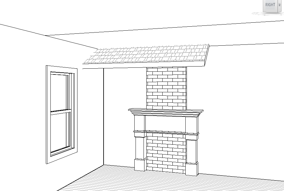

Hello, I am using Revit 2013.
I have created this roof shape by extruding a profile from a workplane, but I can't figure out how to control how it connects to the rest of the roof. It continues on into this room, instead of stopping at the joint of the two roofs. How would I be able to stop the extrusion at the roof joint?
Mon, Mar 4, 2013 at 12:00:29 PM | Roof Extrusion Trouble
If the ridge of that roof is flat, it can be made with the remainder of the roof and that is your better solution.

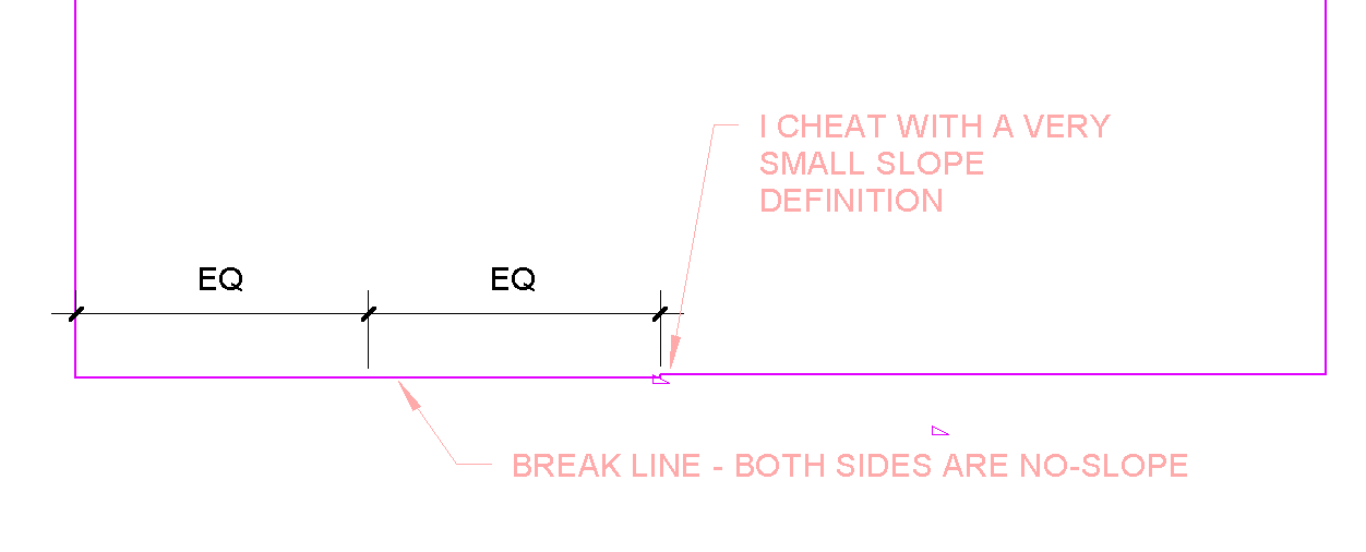

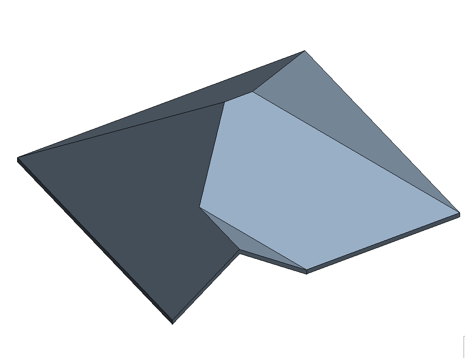

Tue, Mar 5, 2013 at 12:13:26 PM | Roof Extrusion Trouble
I cheat a little but it can be so small it doesn't show.  See views.

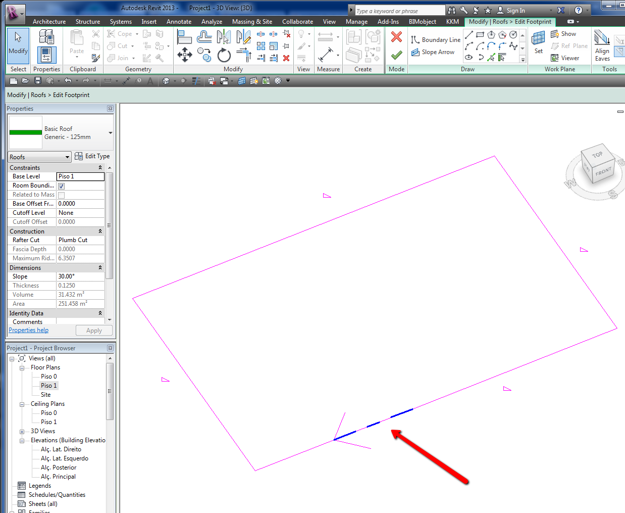

Tue, Mar 5, 2013 at 12:39:04 PM | Roof Extrusion Trouble
Joined: Tue, May 22, 2007
5921 Posts
4 Stars: 205 Votes
No need to cheat, break the line then use the "Slope arrow"
Tue, Mar 5, 2013 at 12:43:01 PM | Roof Extrusion Trouble
Your right Ty,  I hade forgotten that.  I broke the line initially and could not get it to work.  I forgot the arrow.
