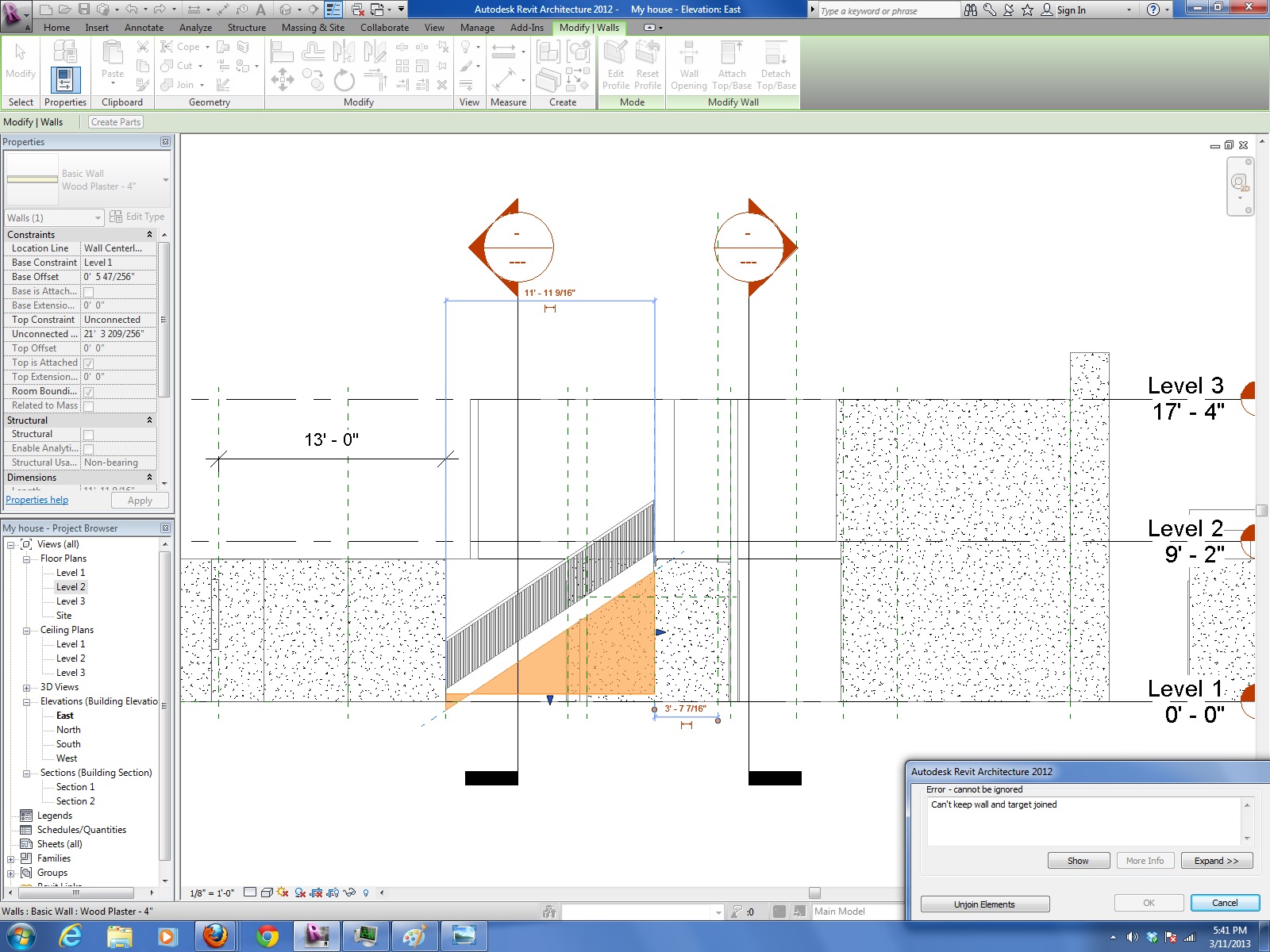

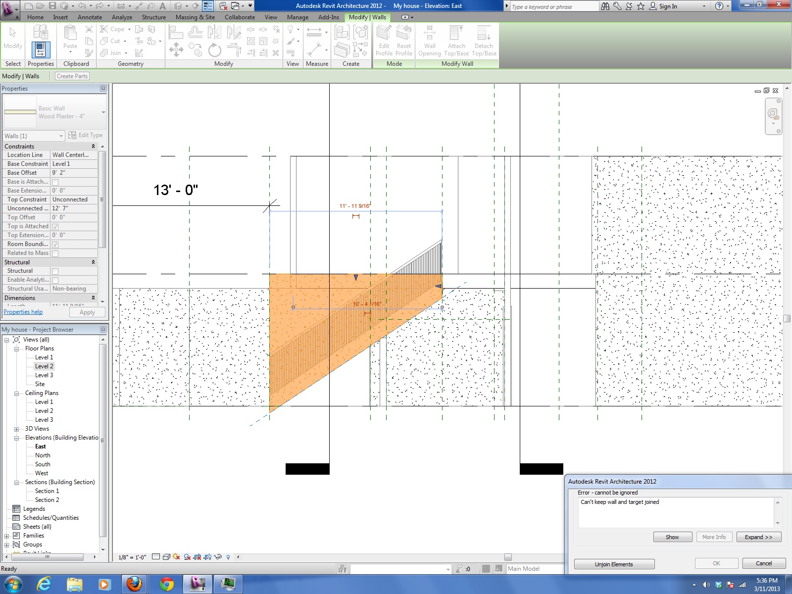

I tried but I'm getting ERROR message.."can't keep elements joined" see attached pix.
Any idea what I'm doing wrong?
Thanks

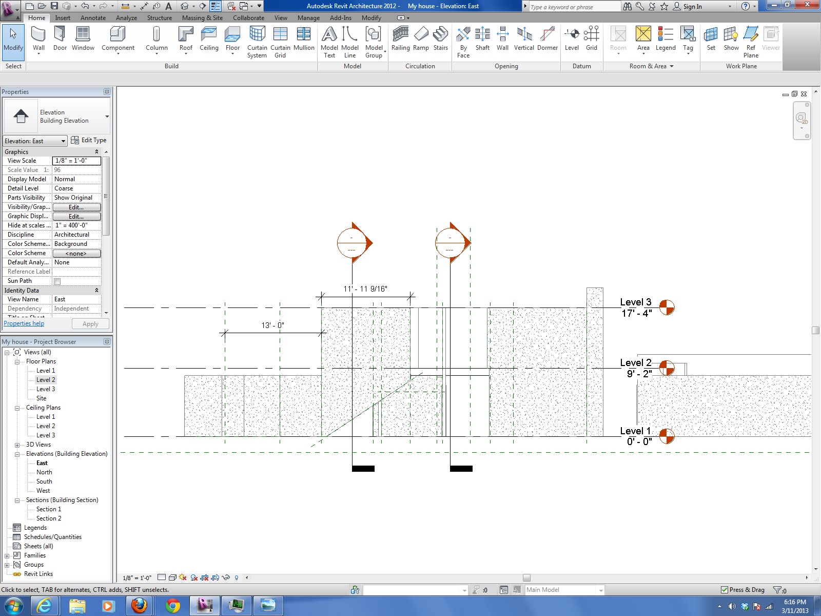

Got it...here's how I did it in case anybody runs into the same issue
1. Draw reference plane in Elevation
2. Draw wall in floorplan

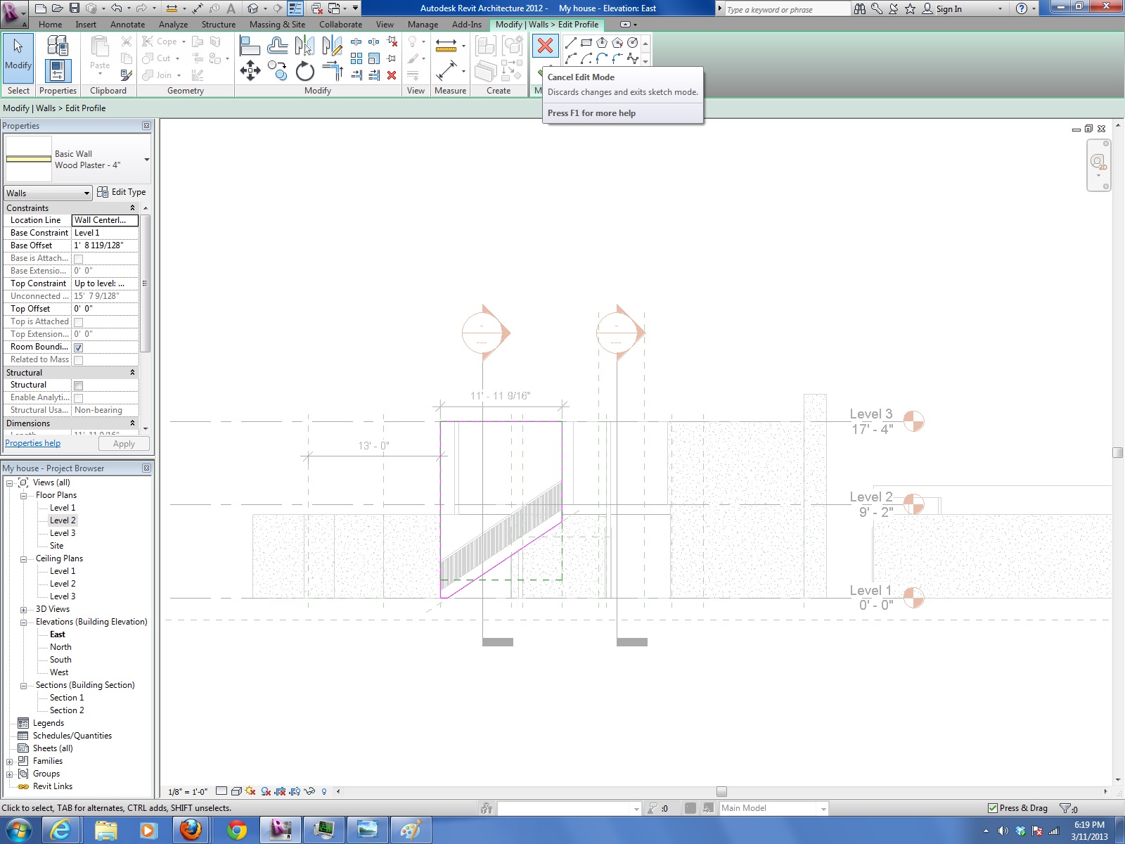

3. In Elevation pick wall - then click "Edit Profile" under Mode in the Modifying command
4. The wall will appear in magenta lines - Now you're able to edit the outline of the wall.
5. Finish
