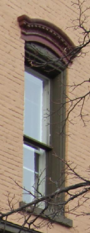

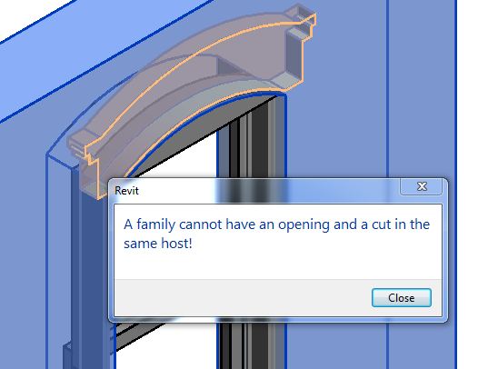

Hi all, I want to make an arched window in a masonry wall. So far so good, but when I want to add the stone sill and the ceramic trim at the head by cutting into the wall I discover that I'm doint something wrong.
- cannot make cut and opening in same host
- in elevation with shadows shadows are cast on a phantom plane and you can't see in. (maybe as simple as view settings)

Delete the opening cut and use 'Void extrusion' only.
