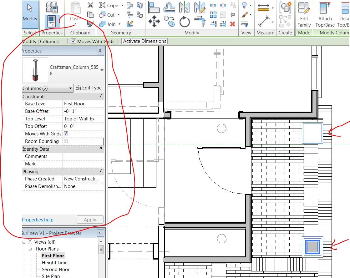

So check this image. I have two columns, they are exactly the same, but they dosplay different. also one changes to show new, and the other was white, now, one is cut at a different plane or something. anyone got any clues? or is this just a bug.

Let's see a 3D shot. Are they both at the same base level?

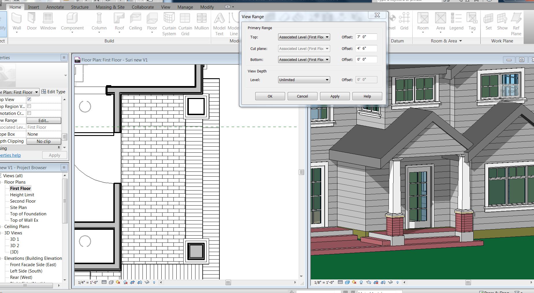

Here you go. window tile!

Do you have any "Plan Region" around that column?

The column might be attached to the roof...delete the column and place it again.
