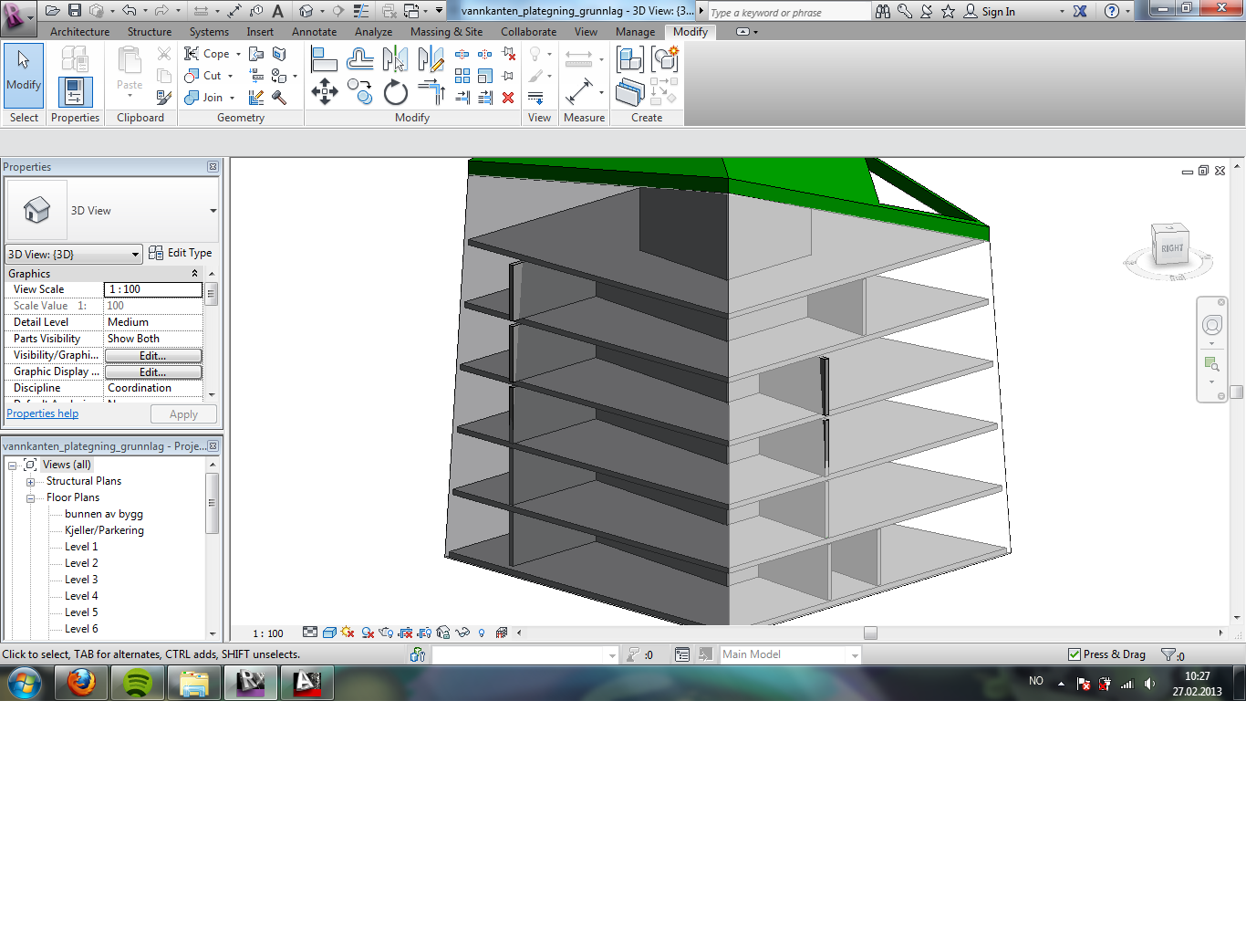

I have a problem with cleaning up and intersecting inside walls, with outside slanting walls.
This problem has been eating me up, so i hope someone can help?!
Look at the pic to understand.
Thanks

You'll have to EDIT those walls PROFILE to do what you want....

It seems to work, only i can't snap the profile on to the slanting wall, getting them to intersect. ?

It doesn't look like you have a wall applied to the exterior yet.  You should be able to use the pick lines tool to grab the slanted profile.

Both suggestions worked nicely! Thanks alot!
