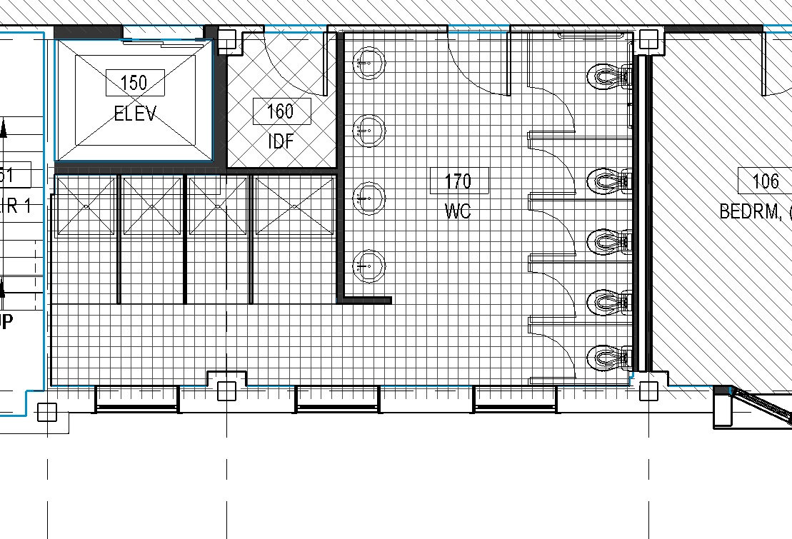

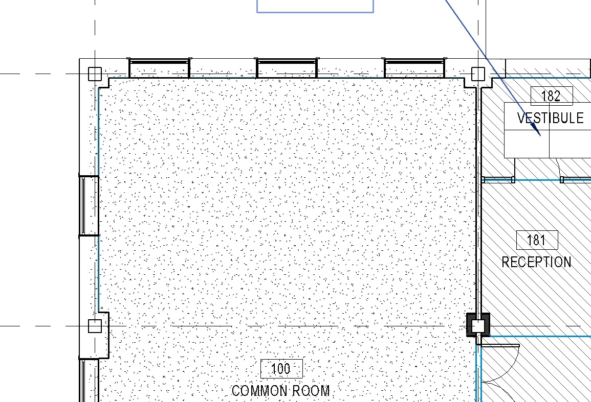

Hi
I am trying to apply floor finishes(via a color legend method and not 3d floor finishes) to a revit model. But due to some reason they are exploding out of the enclosed room areas. I have a few ideas but am not sure what to do to solve this problem as this is happening in almost all the rooms.Additionsally the other problem is that the hatches only show up in the wireframe view - and not any other view
1. Since the model is in design phases room enclosing regions of existing, demolished phases are getting mixed up with the new walls
2. Bounding regions getting mixed up
3. Maybe a problem of worksets.
How can I solve this issue - has anyone seen this before
Mon, Feb 25, 2013 at 10:35:56 AM | Floor -Finishes expanding out of room areas
The reason they go beyond the romm is because the room is not enclosed.
For remodel projects, make sure the phase is correct and the room is in the correctly defined phase.
A HINT:  Always set multiple views as necessary for each phase and work in the correct phase in that view.
