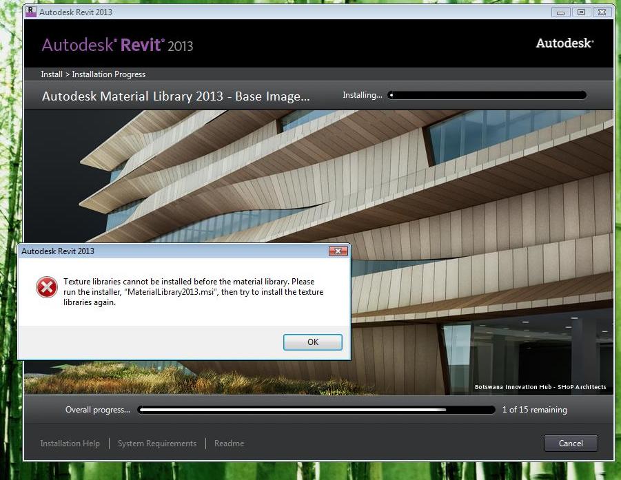

During my installation when it is almost done a message pops up that says "Texture libraries cannot be installed before the materials library. Please run the installer, "MaterialLibrary2013.msi" then try to install the texture libraries again."  I have run the msi installer and I have a materials library listed in program manager but it still gets the same error message and failed install again.  I have windows Vista.  Can anyone help?

Who is your software reseller or did you get this software thru a different means ?

Hi DG,
I am a student with a student licence and having trouble getting a reseller to help.  School is working onit too but they do not have a close relationship with a reseller Rep.

The answer to the Texture Library Error during Install is that it won't install on a Windows Vista OS. I had to upgrade to Windows 7 - JAHLA
