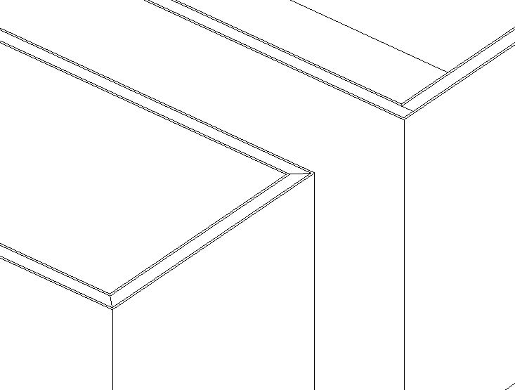

I'm still on the process of getting this all figured out but the main problems I'm running into with the wall framing is where the top & bottom plates are extending past the wall corners.
using Revit 2013.
What am I missing here?
Thank in advance

How did you put the top and bottom plates in? Are they sweeps that are a part of the wall structure?  Did you try using the wall joins command and change it from Butt to Miter?

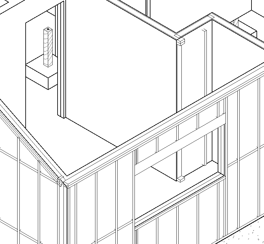

Here we go.  Still a learning curve for me where everything is.  Didn't realize there was a purge in it or I'd had that done yesterday.
I find it's holding the plates short or extending them the same distance past the corners

The wall types that you have in the attached file do not have any sweeps in them. I have attached the same file with a 2x4 double top plate sweep applied to it.  The edges clean up together.

OK, So I'm still at a little bit of a loss.  Did you apply the sweep after you created the framing?  In what you'd sent me it seems like the top plates & the wall are one entity rather than the framing being seperate from the wall.

The plates are a part of the wall.  Edit the wall, edit the structure, switch the view in the Edit Assembly dialog box to Section and under sweeps you can add them to your wall assembly so they are all one part.  Are you really going to show ALL of the framing in your project?  That is probably advised againt.  You can just use details items in sections.
