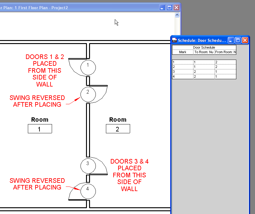

Door numbers are set to be sequential upon placement.  As teafoe says, they can be renumbered and you can find apps to help you renumber them.
Doors do have from to properties and they can be controlled based on placement.  See my attached images.

At the moment (Revit 2013), room numbers and door numbers are not associated. Other similar associations have been requested, but don't exist yet, unfortunately. There might be some third party applications that help on this.
