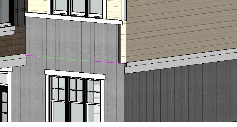

Maybe you can help me with this other probllem, I have the front wall cladding higher than the second floor by about 4 ft. and the side wall makes an ugly join how to fix this? I have attached a pic.

TRIM the walls

He meant - use the wall trim command.   But there are more problems here.
Revits wall trims don't work well with stacked walls or any walls that don't align the same wall type / thickness.  You may have to splt a wall horizontally to allow it to join differently at your junctions.

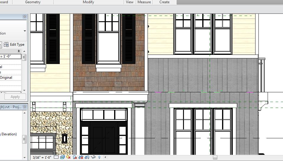

Ive done a stacked wall now on the second floor with horizontal on top and vertical on the bottom, how can I get the vertical siding lines to match up from first to second floor?

Use the "Align" tool

I've tried to to align the two edges, tried the center of top wall and profile edge line of bottom nothing changes. Could you elaborate on what to lines I should be aligning? I appreciate all the help!

You have to align the PATTERN lines and not the wall, use the TAB key to help you.
