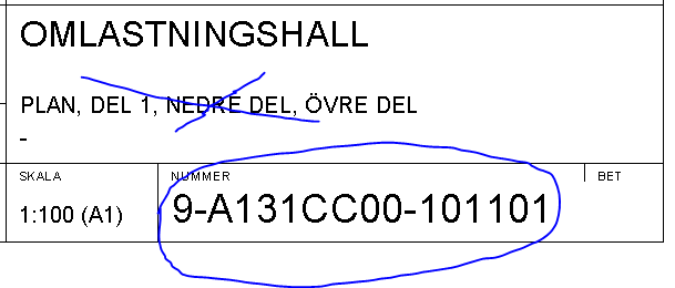

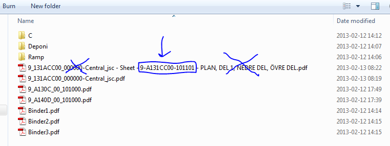

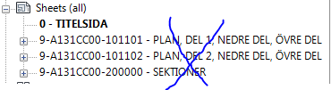

Is there a way to only get the sheet name when plotting to PDF? When I plott I get a lot more text in the file name then the sheet name, se attached pics.
I know there are third party software for renaming files, but I don´t belive that is the right way to aproch the problem.
Please help me! It is not fun to rename 100 files every time we send out drawings.

Plotting to PDF is dependent on your PDF print driver.    The limitations are based on that - not Revit.
What are you using?

Thanks for fast reply. We are using Adobe PDF or PDF-XChange 4.0.
But it feel strange that it depense on the printer and not on Revit
