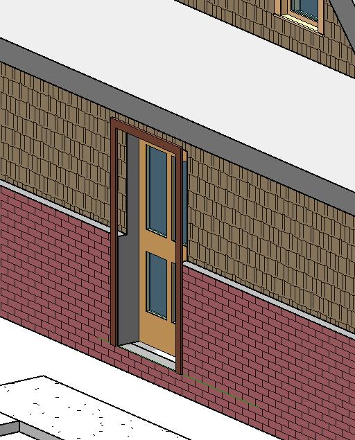

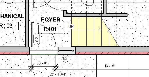

I've inserted an exterior door in a brick and shake stacked wall(see attached). The outside casing is flushed out with the masonry, but the door is flush with the shake siding. How can I bring the casing back to sit on top of the shake siding? Is there a way to turn the masonry in at doors and windows?
Thanks!

Think about this!  You have a vertically flat object you have placed against a vertically stepped surface.  How's that working for you?   It doesn't!
You need to flush your exterior surfaces or not use that kind of trim.
"....Is there a way to turn the masonry in at doors and windows?"  << Look at your wall definition and read your HELP on wall properties.

I've checked the HELP on wall properties and [it looks like] I need to set the Layer Wrapping. Trying to follow the Help on wall properties, I don't see the 'Elements' panel to select, Exterior, Interior or Both.
You suggest flushing exterior surface, which is not an option due to the design aesthetic. I am planning on modifying the wall to place a limestone sill on top of the masonry.
The trim is part of the door assembly, in Revit and in reality. Trim is nailed to the sheathing and not glued to the face of masonry, though I'm sure someone has tried it with Liquid Nails.

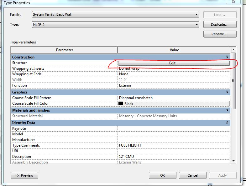

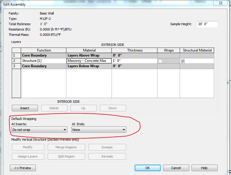

"Is there a way to turn the masonry in at doors and windows?"
You need to go into your WALL properties, not the stacked wall properties but the wall that makes up the portion of the stacked wall and change the wrapping at inserts from none to both.  As far as your door trim is concerned WWHub is correct, how would you actually build that?  You need to either fix your wall or fix your door family.

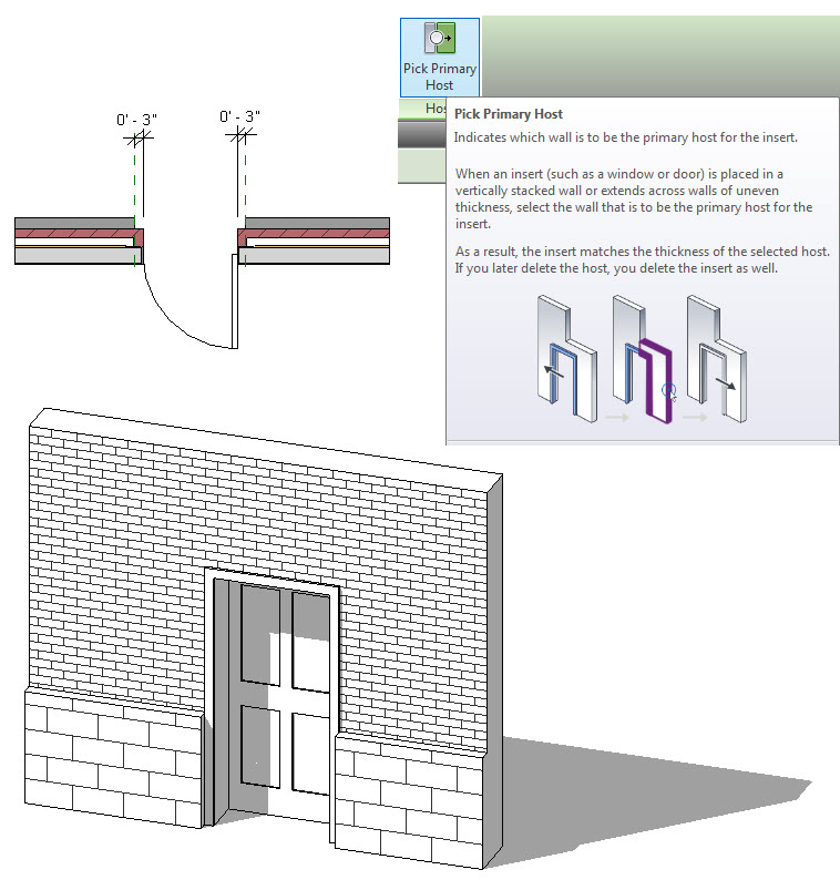

Quoting Memmelle1 from 2013-02-12 19:01:58
"How can I bring the casing back to sit on top of the shake siding? Is there a way to turn the masonry in at doors and windows?
Revit provides a tool to select which of the walls in a stacked wall is the primary host for a door or window. It would make the trim be at the wall with the shake siding if you select that wall as the primary host for the door. This will not take care of cutting the CMU units to make room for the trim, though, but that can be fixed with the wall opening tool.

Alfmedina,
Thank you for correctly addressing my dilema. Nice illustration too! That is exactly what I've been trying to get accomplished.  I'll give that a shot. I've been trying to learn Revit by myself and YouTube videos doesn't always cover every issue. Winking
I'm not sure what you mean about the 'cutting of the CMU using the wall opening tool', but I'm sure I'll find out soon enough. From your illustration the brick needs to move out from the door on both sides another 4" (if trying to maintain masonry opening) so that the casing carries down to the limestone sill(which is a question for tomorrow).

Alfmedina,
I gave it a shot and at first(working in plan) I wasn't able to select the upper portion of the stacked wall. In elevation or 3-D, I was able to select the shake siding and it worked...now on to the wall opening to expose the rest of the casing. Smile

Oh, in plan view it might be difficult to select the upper wall, because of the cut plane. In a 3d view it is easy.

Wall opening tool worked easily enough. How exactly did you get your brick to return like you have shown in your illustration? Can you tell me where this setting can be found?

Okay, I just looked at my plan and, after using the wall opening tool, the door is no longer visually attached to the walls. I deleted teh wall opening and got it back to the correct illustration. I tried the Cut Geometry function and that didn't work. I tried an extruded void and that didn't work either. Am I missing something with the Wall Opening function because it cut through the wall all the way(like a 'wall' opening)? Is there  way to control the depth of the wall opening? Any advice?

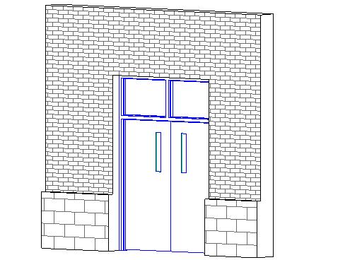

Hi Memmelle1,
The problem is your door family.
Please see attached images, I think that was closer to what your intent.
You may download the door family below and try to see if you can modify it to fit your situation.
http://www.revitcity.com/downloads.php?action=view&object_id=11969

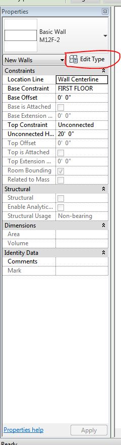

"I think I'm missing something. What (where) do you mean 'WALL' properties? Where do I find the settings for WALL properties so that I may change them? What tab and panel will I find them?"
Click the wall command and find one of the walls that makes up your stacked wall, for example you have CMU on the bottom and brick on the top, find the brick wall, click on it and on the Properties Pallet click Edit Type, then edit structure, then change your default wrapping.

Wow - all of this to answer a question that should have been... "I have a stcked wall with different thicknesses and exterior trim.   How do I widen the door cut in the thicker wall area so all of my trim falls in the same plane as the thinnest wall?
If you can't sketch it, then you have to paint the picture with words.  This is called communication.
