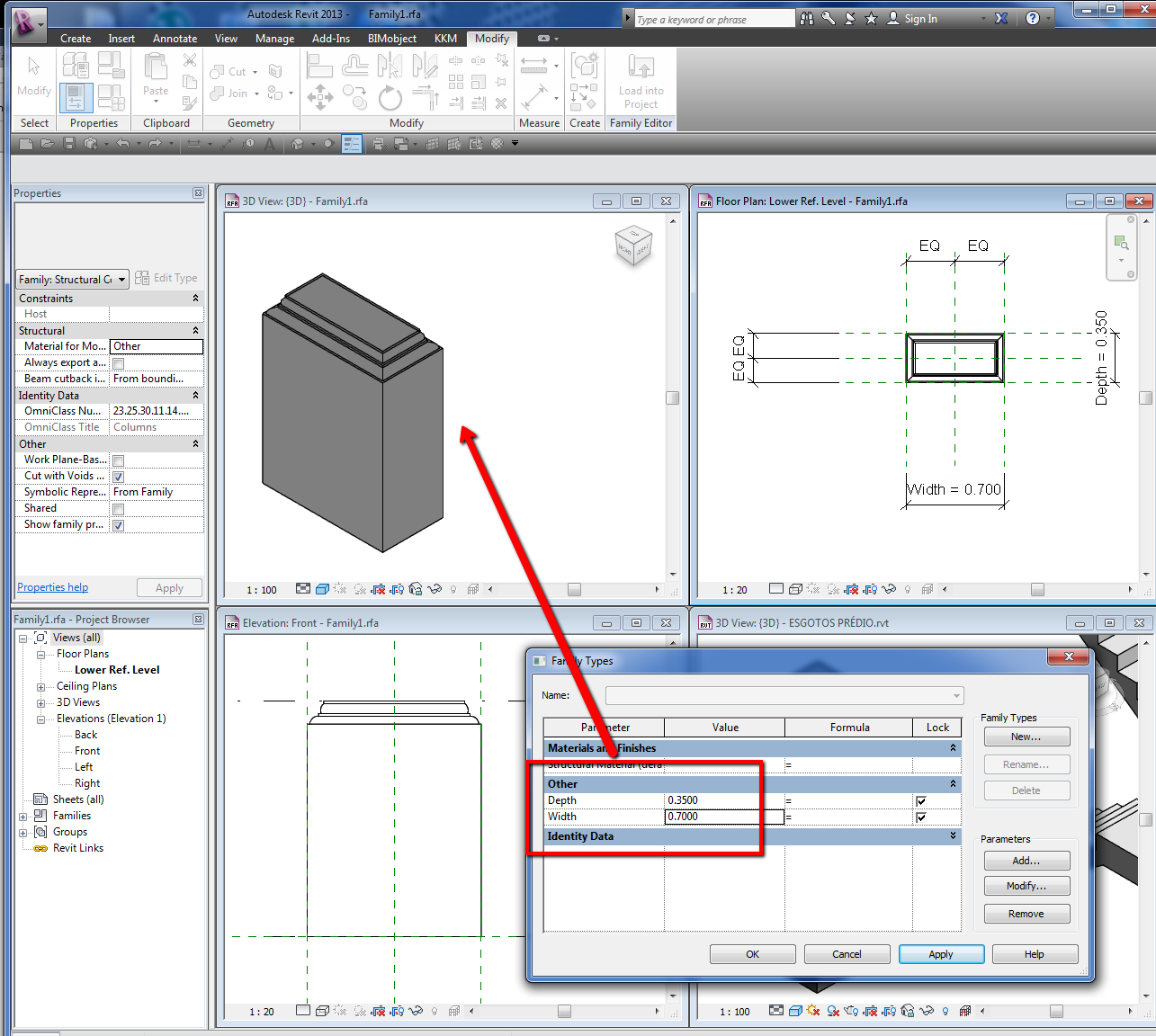

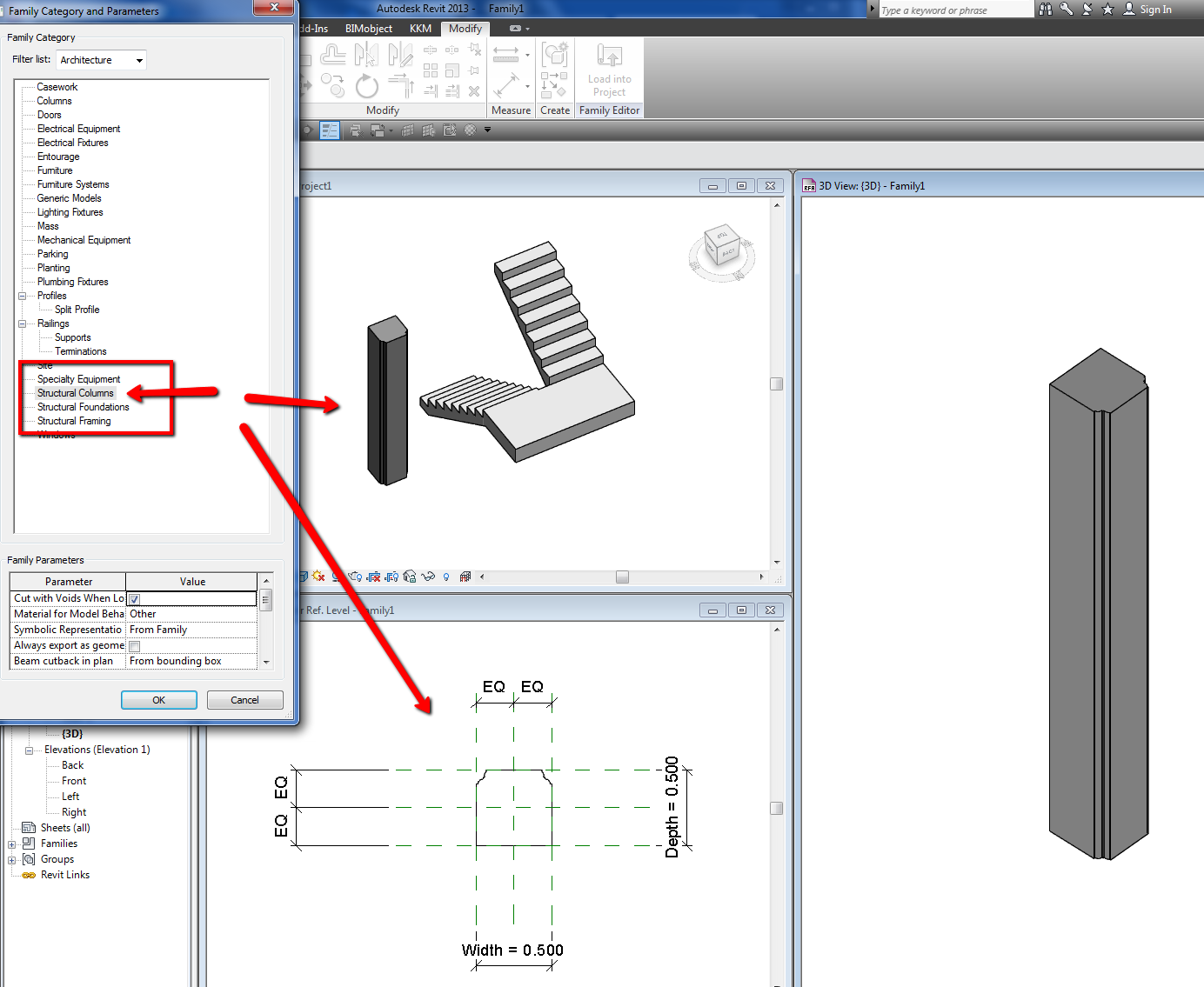

Create a "Structural Column" family

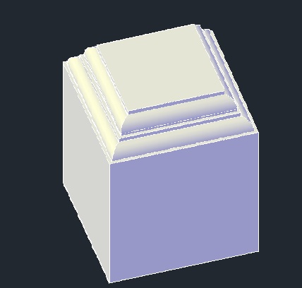

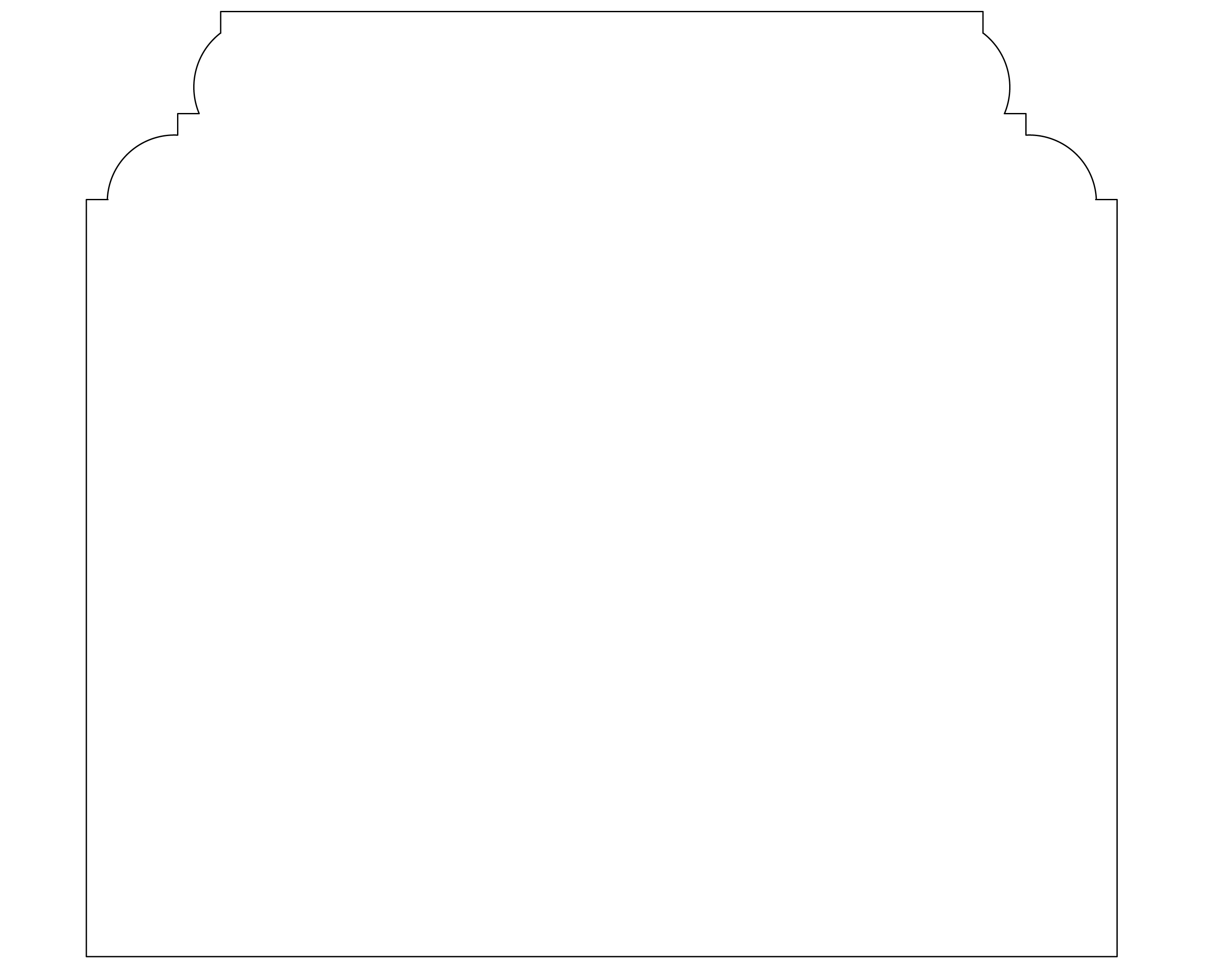

Thank you for your answer. I need to do this kind of coulmn foot. is it possible? if yes how?

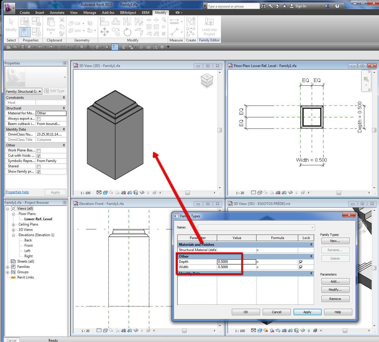

Yes you can, create a rec. extrusion to create the column then create a VOID with that profile to cut the column.

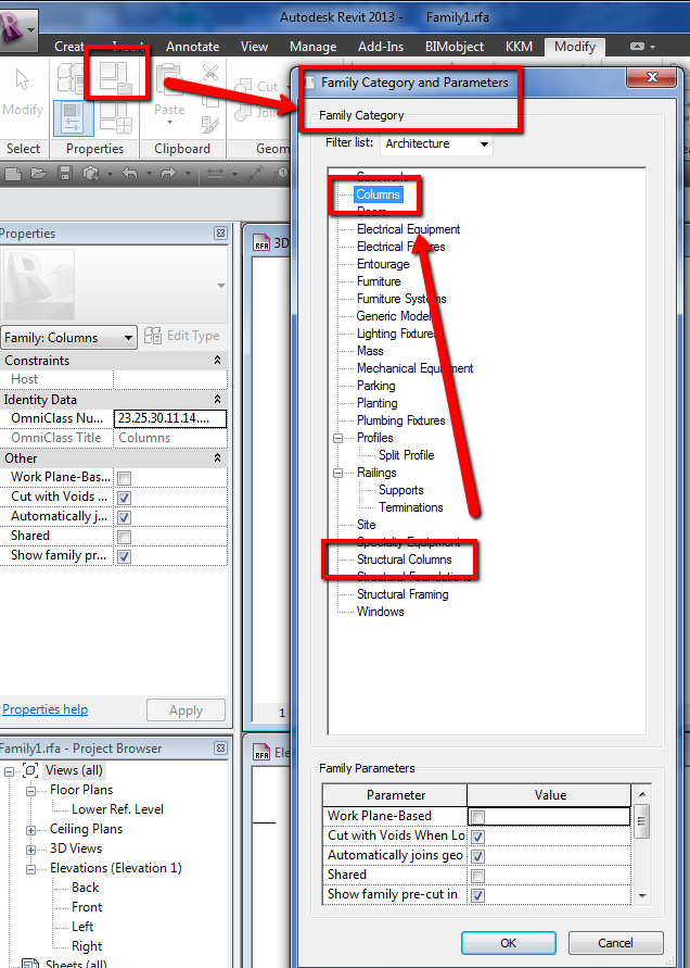

BTW... you can chage the category of that "structural column" to another cat. you know that right?

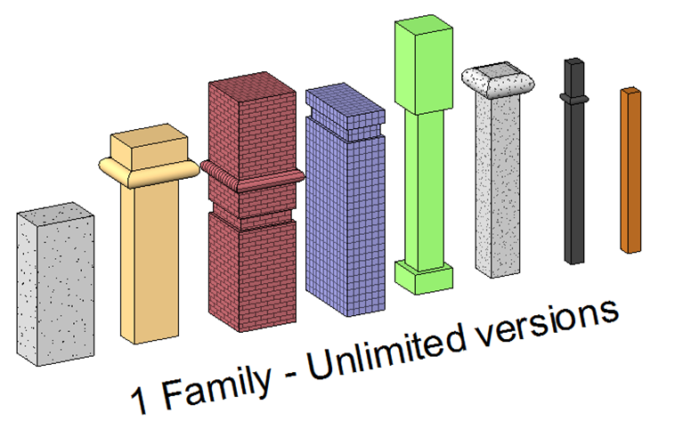

What you want to do can definately be done but it cannot be properly explained in a series of back and forth posts on this site.
You need instance and type parameters, voids, solids. sweeps, extrusions etc. . . it's not as easy as ABC
You answer is however laid out in this 2 hour video series linked below.
