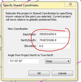

is there a way to increase the coordinate accuracy to 4 places after the decimal when typing in the coordinates.
Wed, Feb 6, 2013 at 8:50:17 AM | shared coordinate accuracy
Change your project units.
