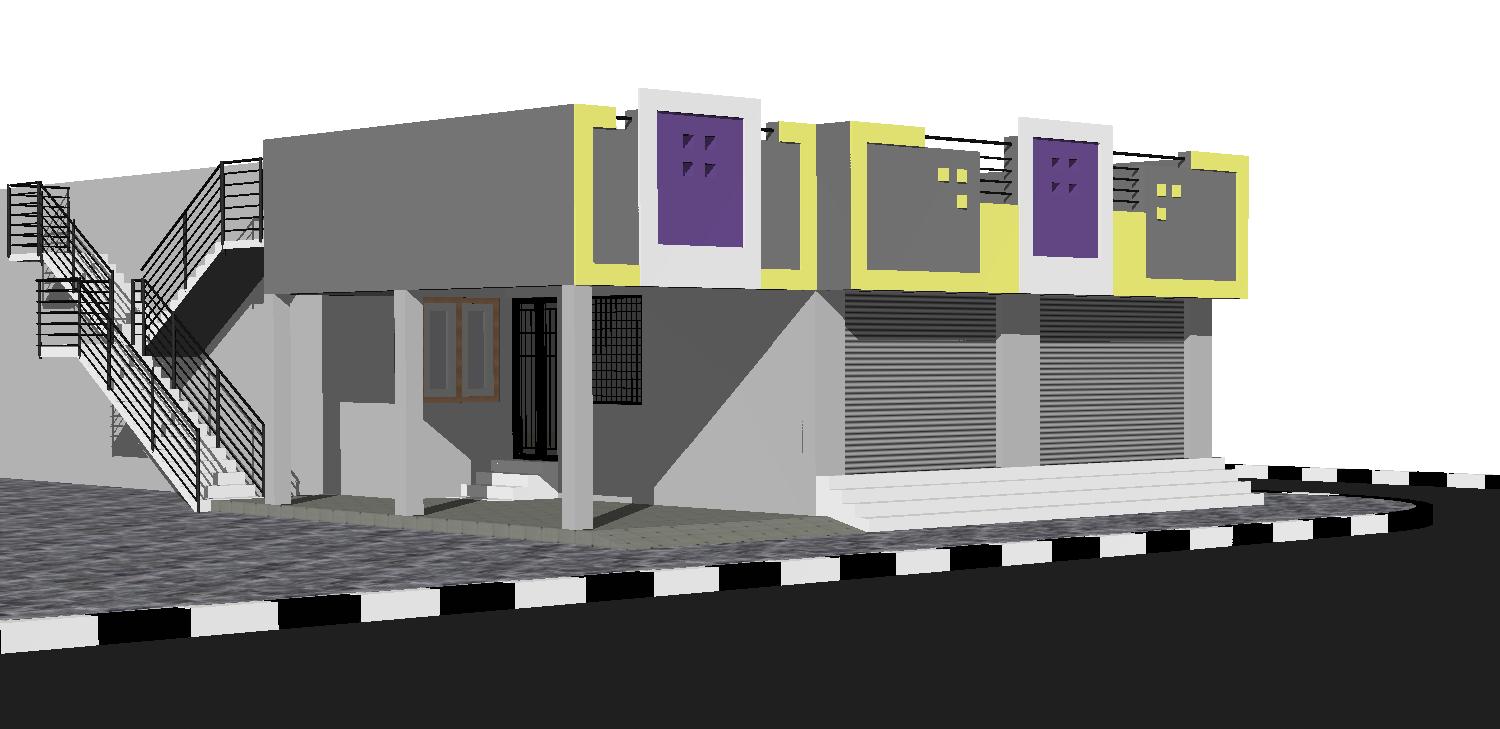

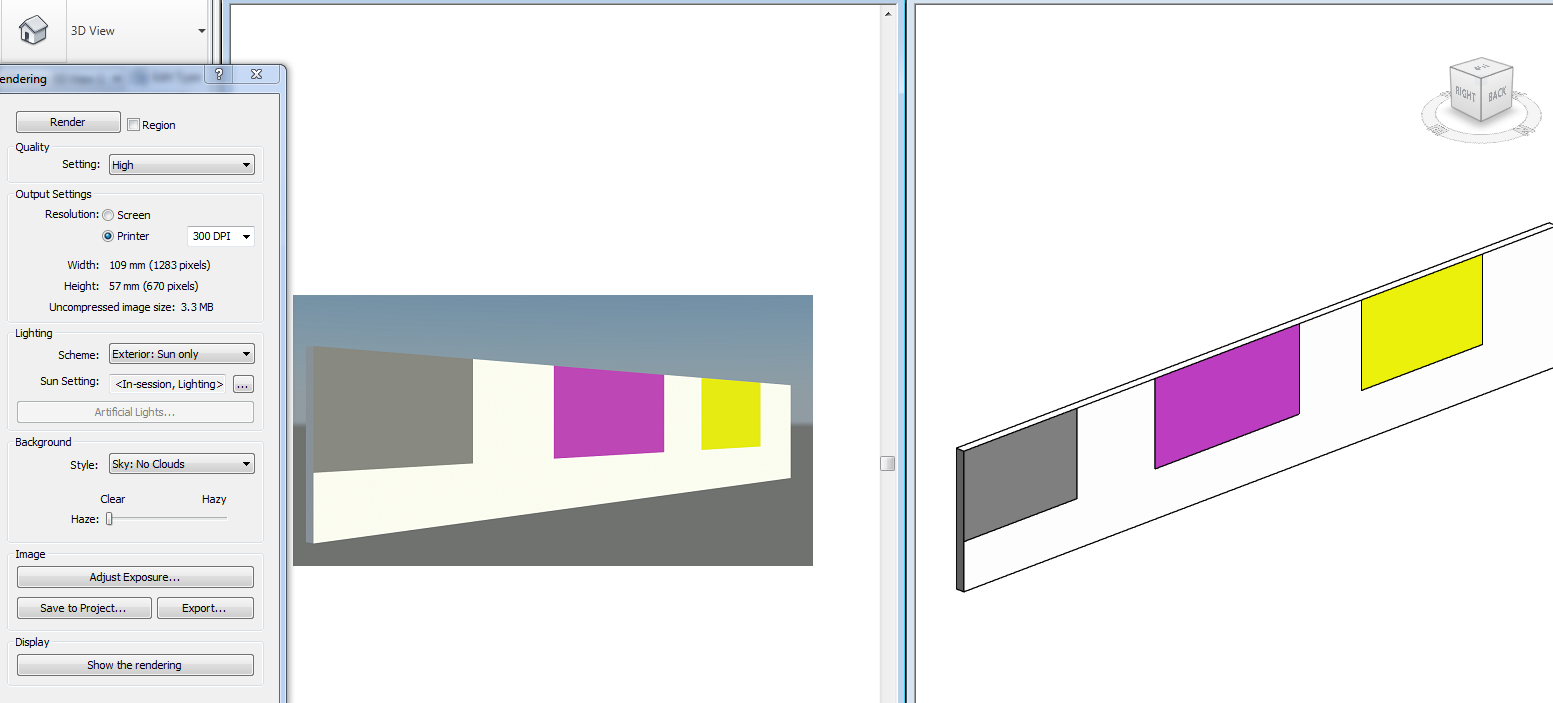

Sir also i attach the jpg files....
001 its after rendering......
002 its  before  rendering.........
pls i got more trouble pls help me/////////

I did like that only sir but the output doesn't came like true RGP...........Pls tell me how set the material to the wall.........

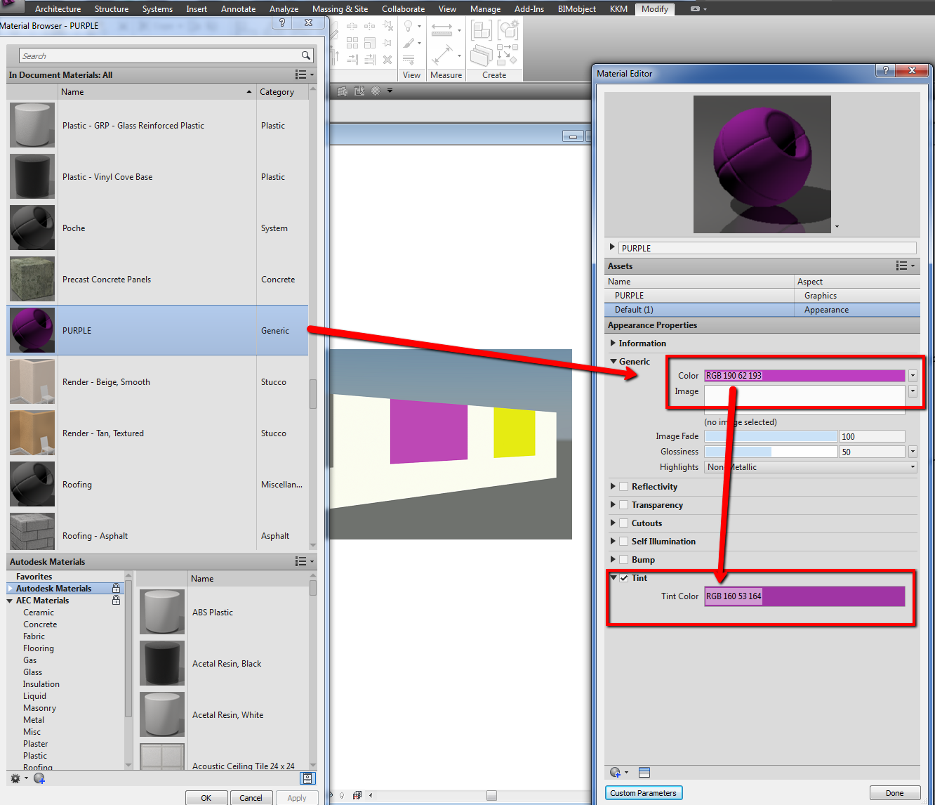

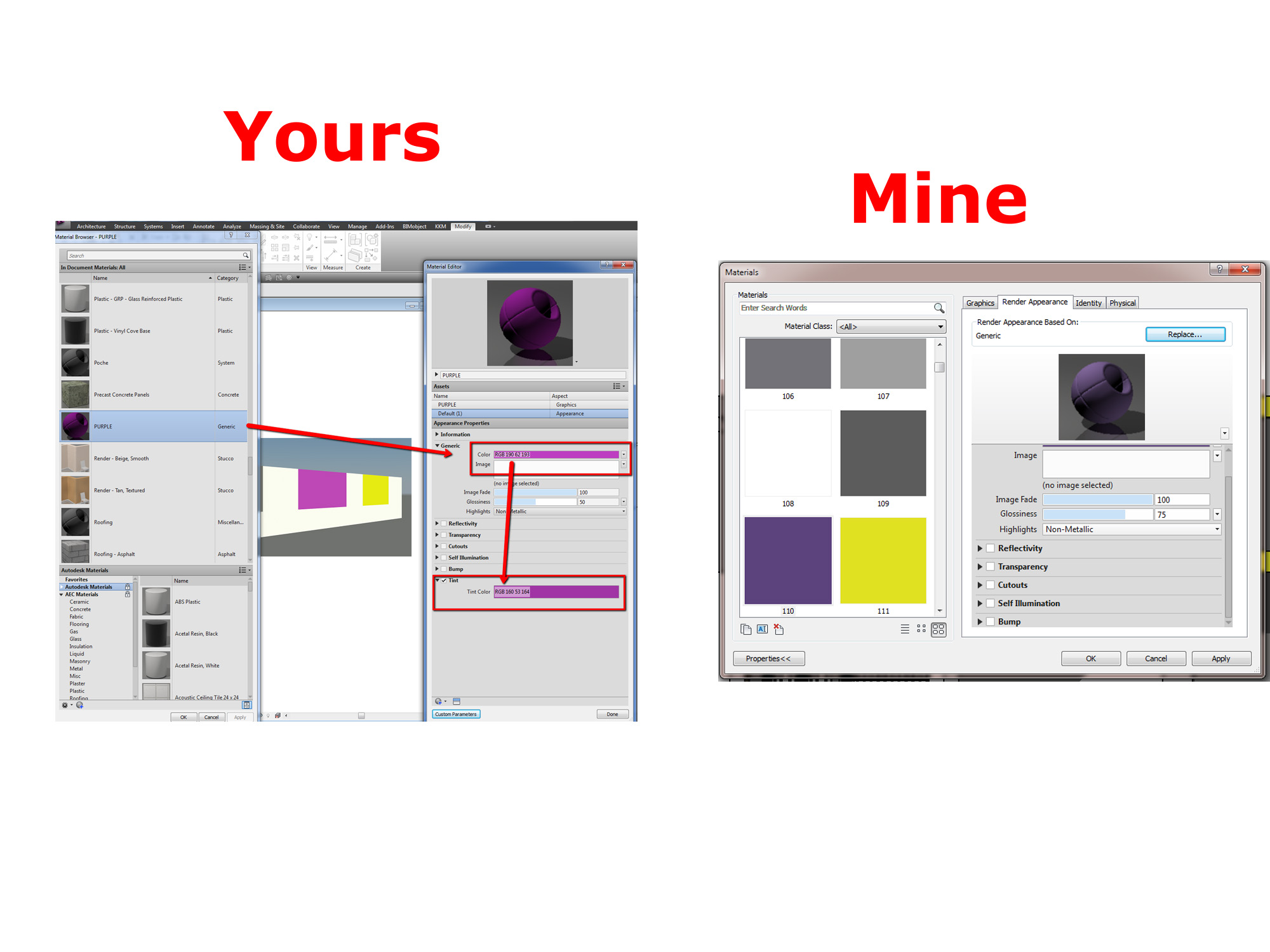

Sir i had another one problem...... I dont have the tint option in my revit software, i am using revit 2011 thats y ah? pls give a solution sir pls.............. Also i attached one jpg pls check it out...........
Fri, Feb 8, 2013 at 4:57:50 AM | How to get high quality output in revit2011
#10
Joined: Tue, May 22, 2007
5921 Posts
4 Stars: 205 Votes
2011... long time... "play" with "Image Fade" and "Glossyness" values

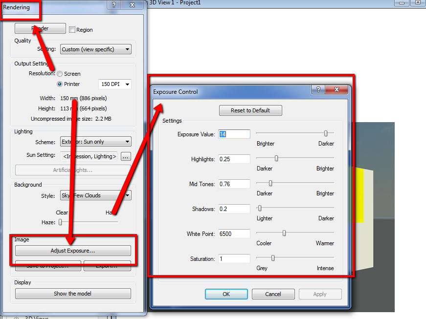

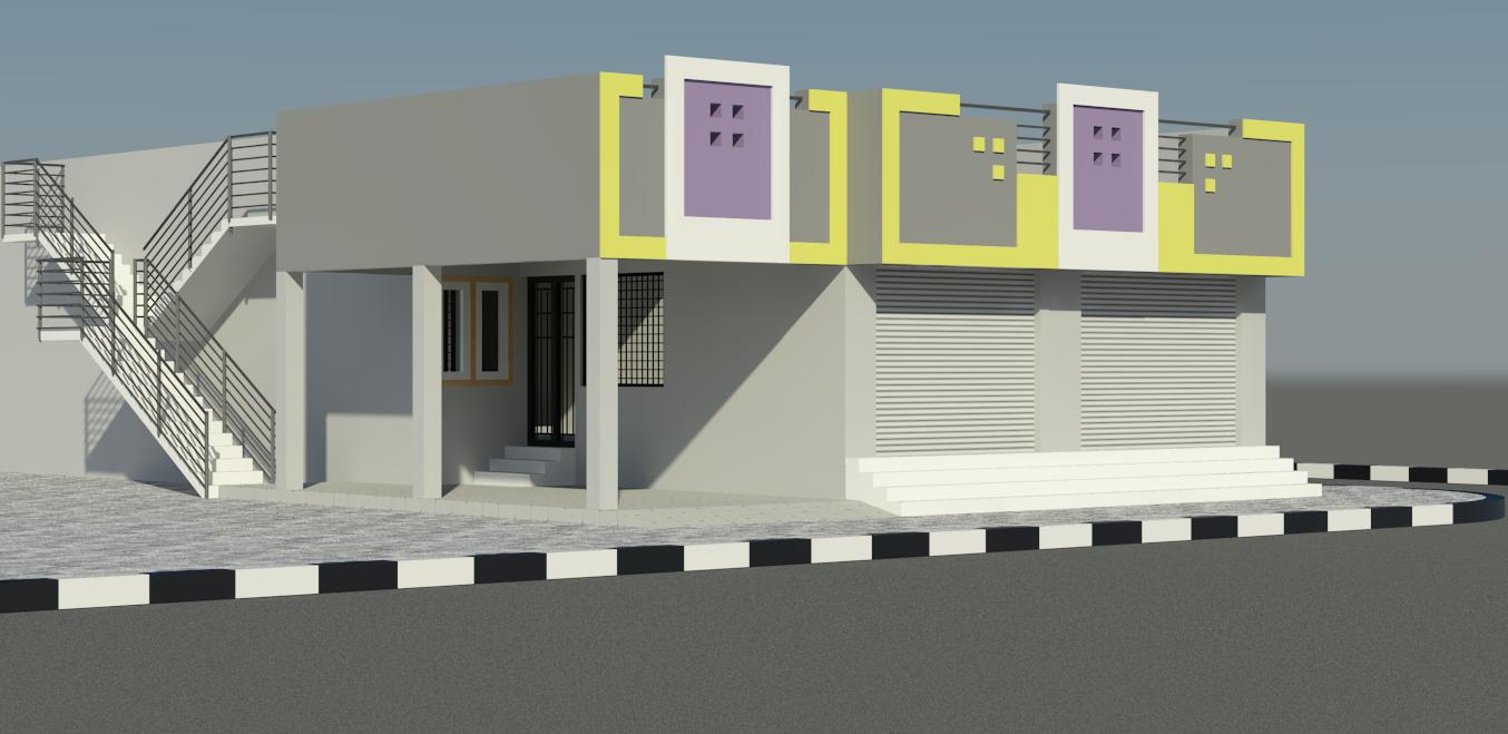

To get the colours to look right we have to make the RGB values darker. Sometimes this means changing values between each render until it looks correct, ALSO you have the "Adjust Exposure" after render, here you can change some parameters like in Photoshop, play with that too...
