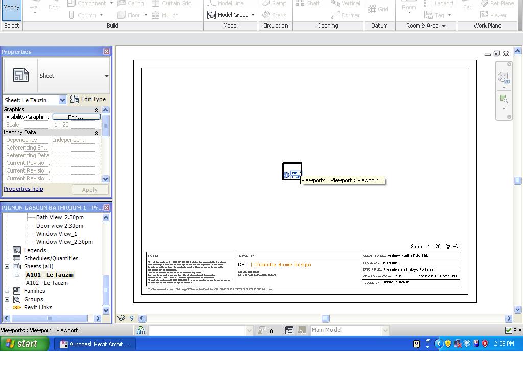

Hi there,
I've created a new sheet, dragged the view I want onto the sheet but all I can see is the Title Scale 1:20 but I cant see drawing all. It's just a simple plan view that I want to dimension.
Have tried adjusting the scale, changing size crop, showing crop edges etc but can never see it.
Any ideas?
Thanks!

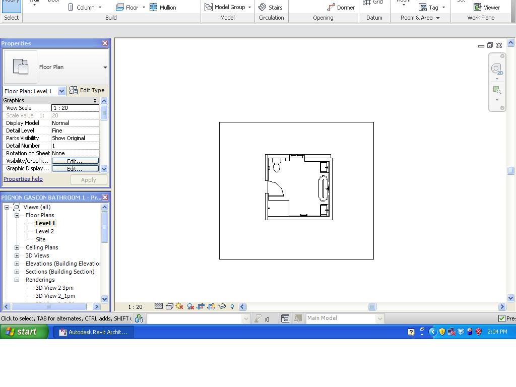

Go directly into the view and make sure the crop window is where you want it.

Thanks, yes think i did that by ensuring the crop box was appropriatel arranged around the drawing, see attachment below...1 shows the original view, 1 shows the sheet view where i cant see my drawing.
Hope to hear back soon
Thanks!

While in the view - not the sheet, change the scale of that view to something a lot larger and see what happens to the view on the sheet..

I know this sounds silly, but try typing ZF (for Zoom fit), I have had this happen before where the view title drop in in the middle and the view is way off the sheet.
it could be something in the view title family or perhaps a CAD link/import in model with an origin that is far away.
