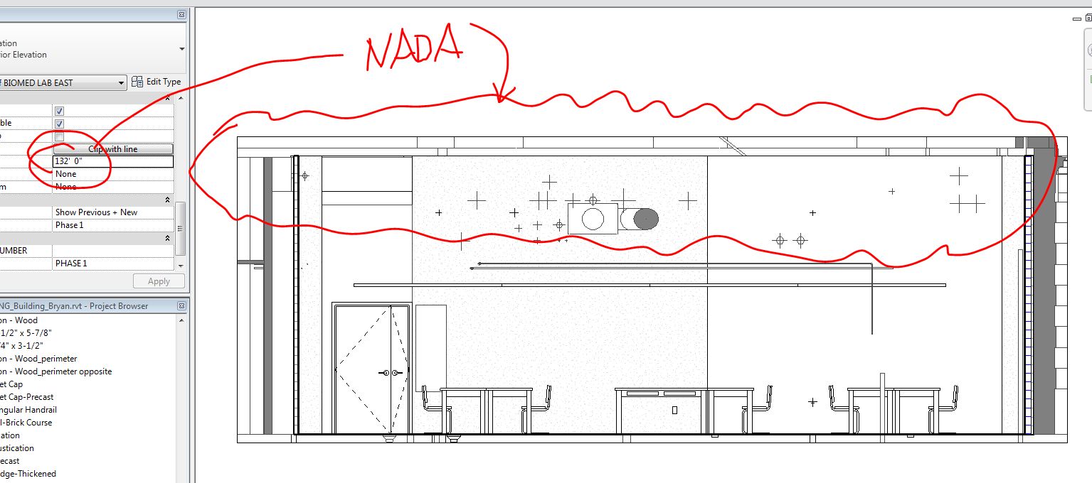

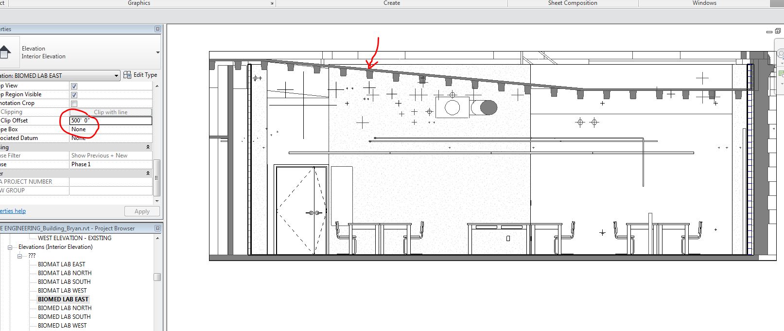

Having trouble with visabilty of linked revit files in sections and elevations (showing up in some views but not others)?
Try increasing your cut depth to 500 or 1000 feet.

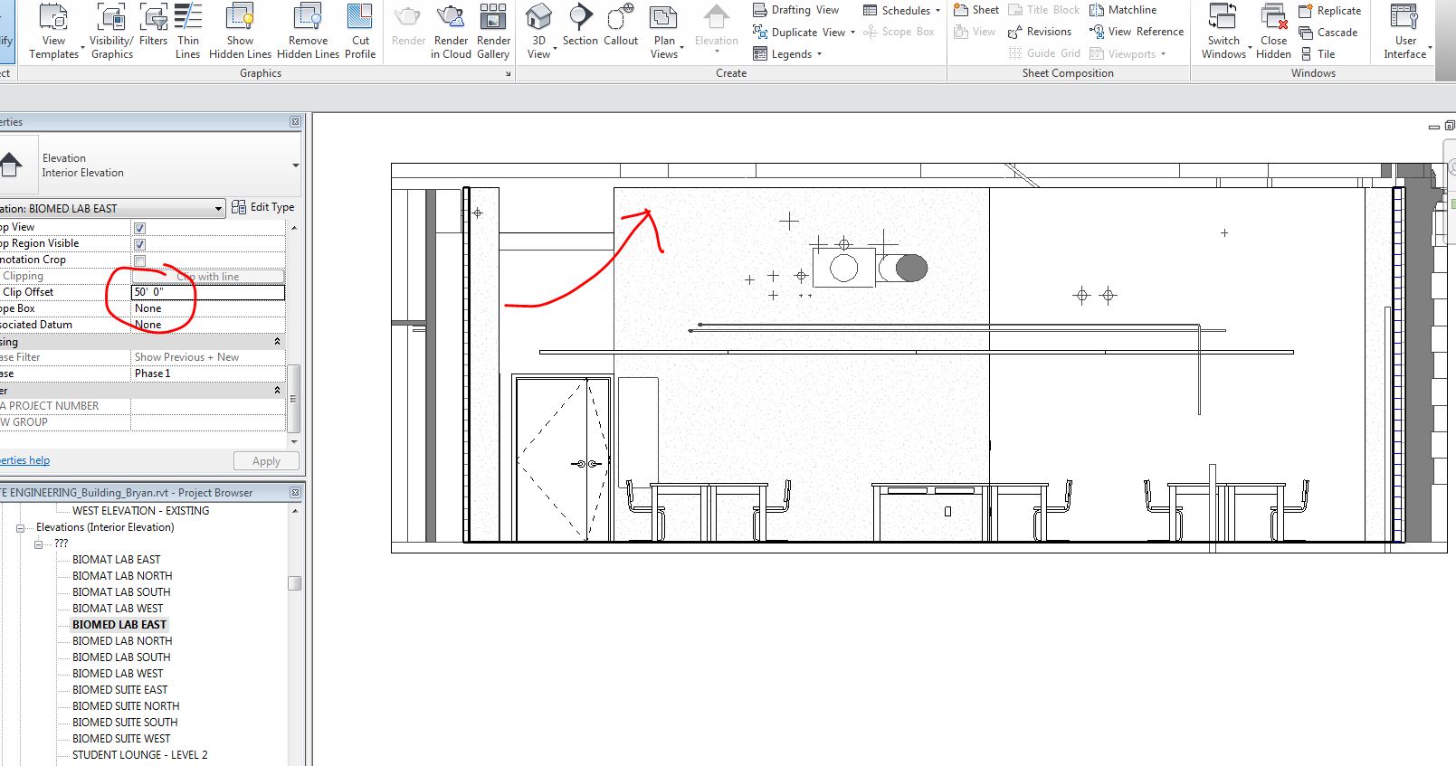

WWHub,
Look at the pctures. The only thing that is different between the two views is the clip depth setting. The section is cut thru the structure model. We have had identical problems on several different jobs, with different kinds of models (site, structure) on several different machines, with several different people. The problem is always the same, the fix is always the same. I can re-create the view, and the linked model will show, but that is another work around and not an assurance that it won't disappear again.
How else could you explain that?

dgcad,
The problem is that on occasion, for no apparent reason, a linked file will not display (in this case it is illustrated by the sloped structural floor- cut hatch solid gray) unless I change the cut dpeth to some expanded range (which often then displays things far off in the background which are unwanted).
I made no change in the worksets display between the two pictures.

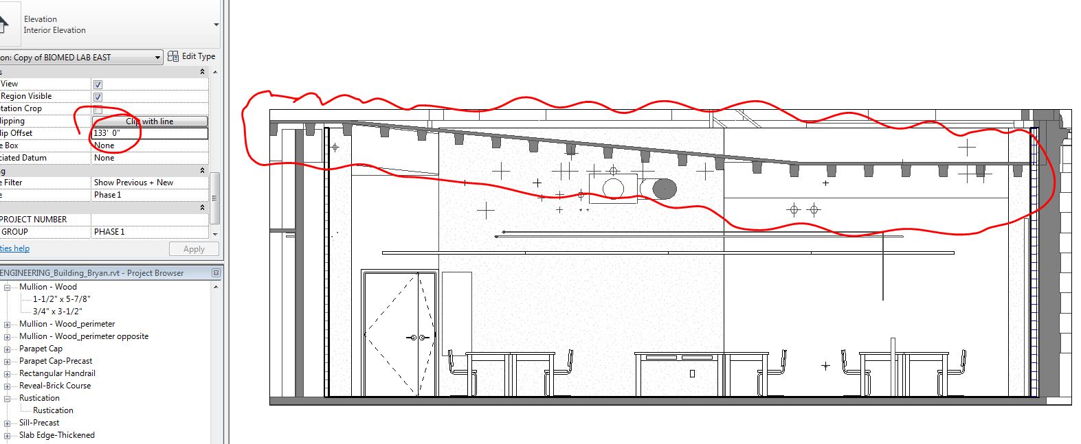

The only setting difference that is required to make the structure model (linked model) visable in the view is to change the "far clip offset" to anything over 133'. This precludes the possibility of any other setting causing the issue. See images below.
If the view is "corrupt" then we are back to fixes and work arounds to the problem, for which setting the "far clip offset" is one.
What "corrupts" a view?
