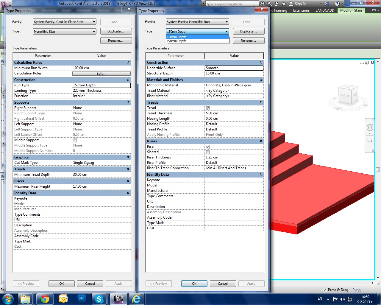

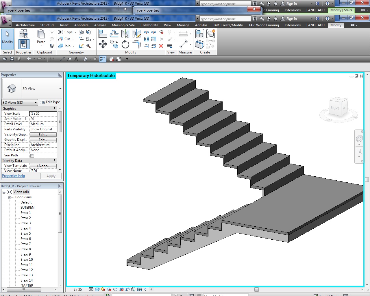

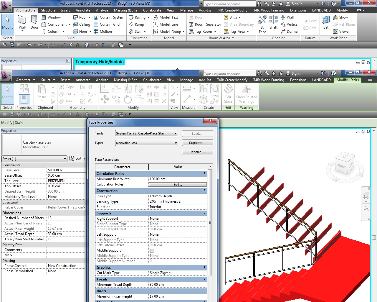

I have a problem with stair . like  shown  on image ( 0 - 1). This is a monolithic stair . Half of stair dissapear. When I attach the stairs over one level  the risers appears( img 2). How to fix this.  I,ve tried to change the type of stairs, delete existing and created new one, restarting  revit couple  times , nothing changes. When I change underside surface from smooth to steped  stair is OK , but i need to be  smooth. Does anyone faced with a similar porblem.I apologize for my bad English. Thanks for the help in advance

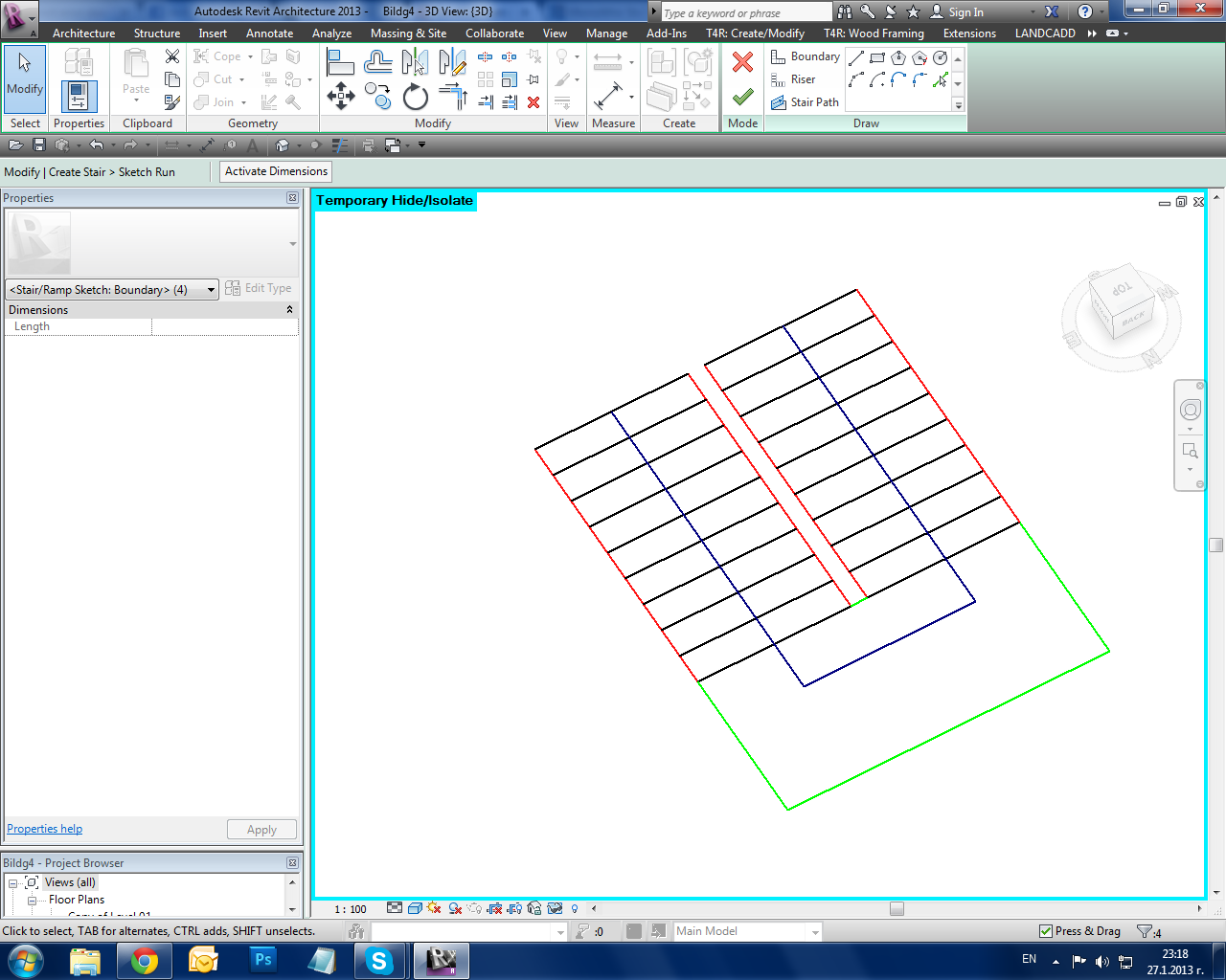

The first thing that caught my eye is what are those red lines in the first sketch image ? I see you are using REVIT 2013 stair by sketch. Usually the risers are black and the boundary is green. Am I missing something ? Perhaps REVIT 2013 specific ?See my REVIT 2013 sketch image.

scetch lines are red because of my personal settings/ selected objects are highlited in red / . I show  them like this to show that boundary lines are splited. I think my problem is caused  because a bug in revit , but  if some one had  similar problem ,please tel me how to fix thisSmile

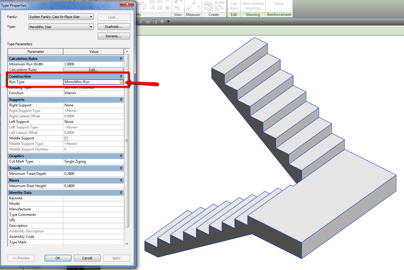

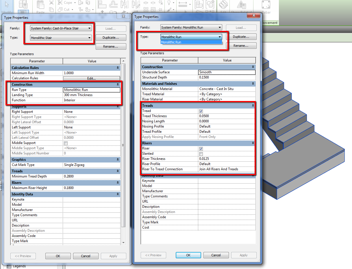

Change the "Run Type" to "Monolithic Run"

Thanx for reply Typhoon , but see on im1 .Something going wrong ,half of my stair is ok . On im2  - my settings ,but  i didn't see   option "monolithic stair.
Edited on: Sat, Feb 9, 2013 at 8:31:05 AM

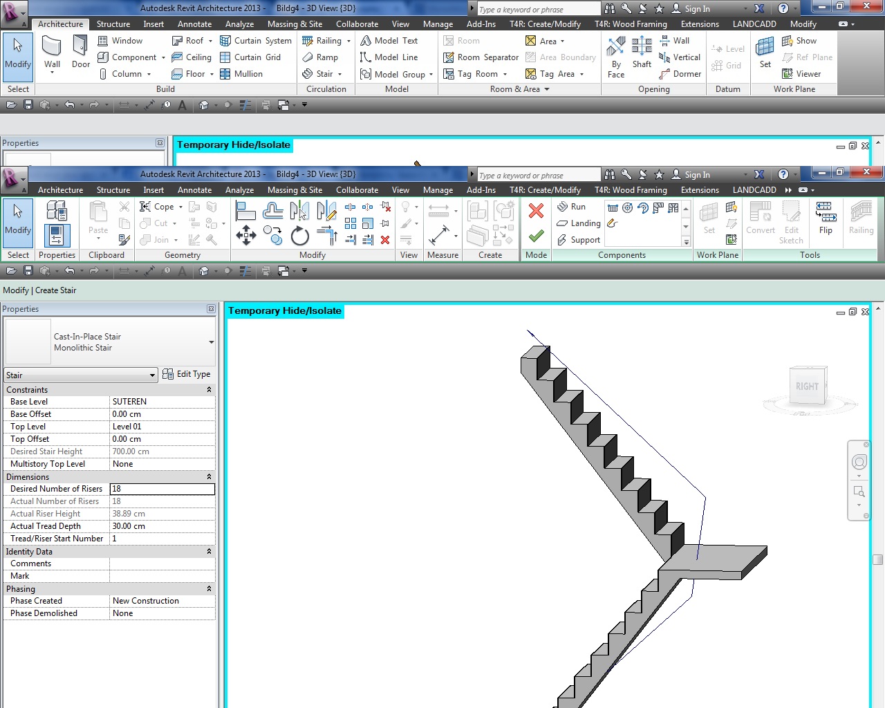

Hmmm... I don't have that problem.... Uncheck "Treads" and "Risers", problem persist? Your version is updated?
http://usa.autodesk.com/adsk/servlet/ps/dl/index?siteID=123112&id=2334435&linkID=21208796#section1
Easy and FAST way: delete that stair and create a new one.

I delete and create new stair over 10 times Smile , all the same. I  fixed this  with cheating  in section view Smile
Thank you. I will donwload latest updates.
After installing updates nothing changes.I think my scene is corrupted.
