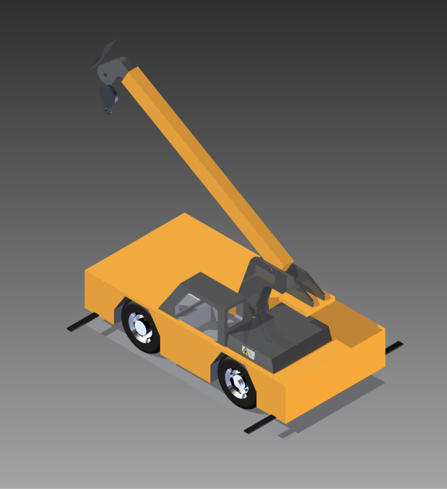

Here is a pic of my crane. It is made up of 6 components: The hook; the first, second, and third parts of the arm; the component that everything pivets on; and the body. Does anyone know if I can still constrain these parts using parameters in revit even though they were made in inventor. Or do I need to completly start over in revit.

I found these 2 post, I am not sure if it will help with applying parameters or not.
http://communities.autodesk.com/india/news/share-parametric-family-information-inventor-revit
http://revitclinic.typepad.com/my_weblog/2008/09/can-you-use-inv.html
Personally your crane does not look very complex so it may be faster to just redo in Revit.

Thanks teafoe5 for the links. I didn't want to start over in Revit but yeh I think your right on me redoing it.
